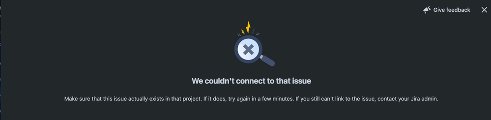

Hey guys, I and my whole team are unable to open any task on the Kanban board in Jira Software.
We still getting an error "We couldn't connect to that issue" with the description "Make sure that this issue actually exists in that project. If it does, try again in a few minutes. If you still can't link to the issue, contact your Jira admin."
It's been going on for days.
Can anybody help me?

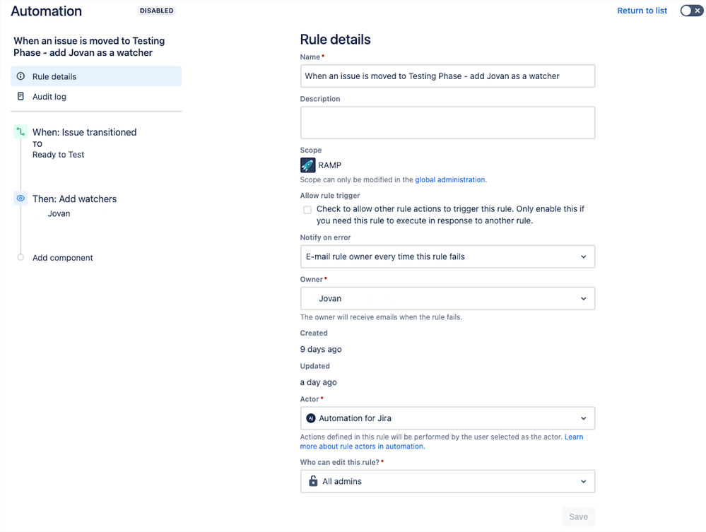

Hi guys, thank you for your help.
I already fixed the issue. There was created some automation which caused the issue. Turning off the automation immediately helped.

Can you share with us what the automation was doing that caused this problem?
Dávid Hamrák
January 25, 2023
Sure, here is the screenshot of the automation. It is weird as it is nothing special.

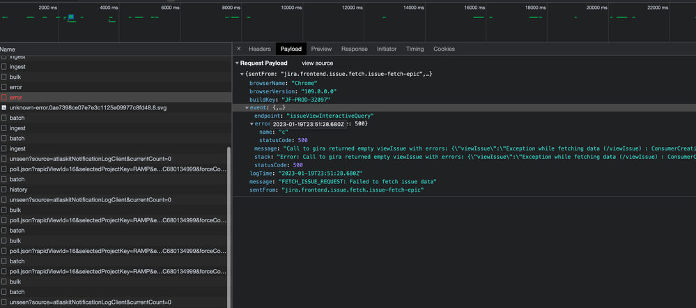

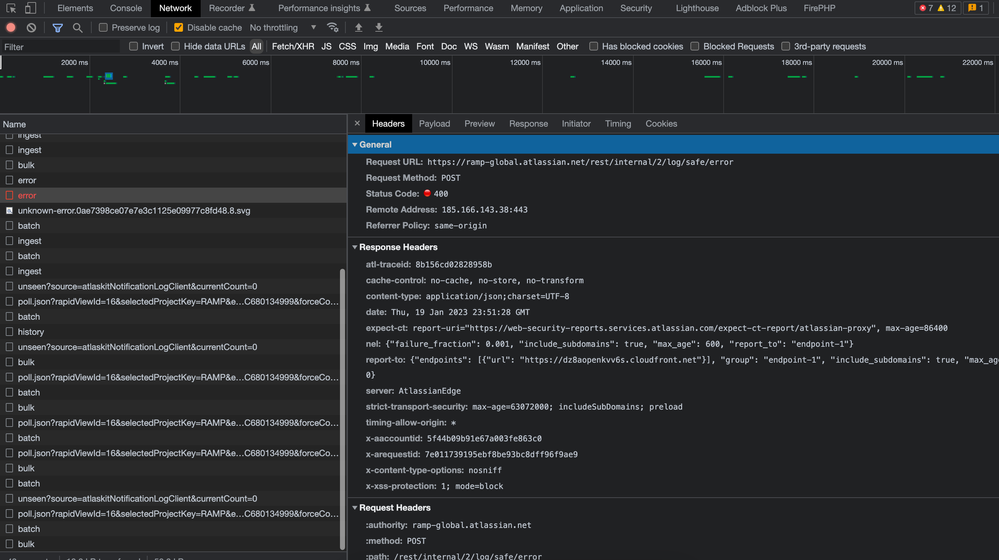

Forgive me, I misinterpreted the information. That is a Build Key. Do you have your Jira system integrated with a development tool the executes builds?
I see in your images that there are two "error" outputs and you are showing info only for the second one. Also they are preceded by a "bulk" action. Can you show us the Headers, Payload, Preview, and Response for all three actions?
