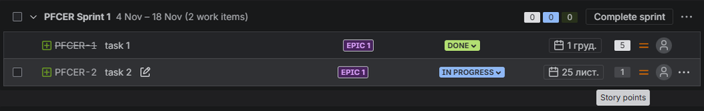

Here by the hover I can edit the estimation:

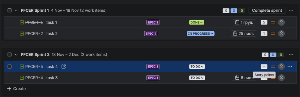

But to add story point estimation for the tasks with no active sprint is not possible at all:

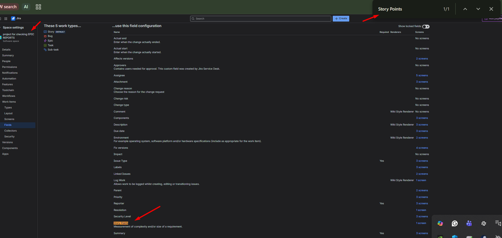

Here I've added the field:
But the field still does not display here:

I need these estimation for my test Epic Burndown.
But I just can't add the estimation for not active sprints tasks.

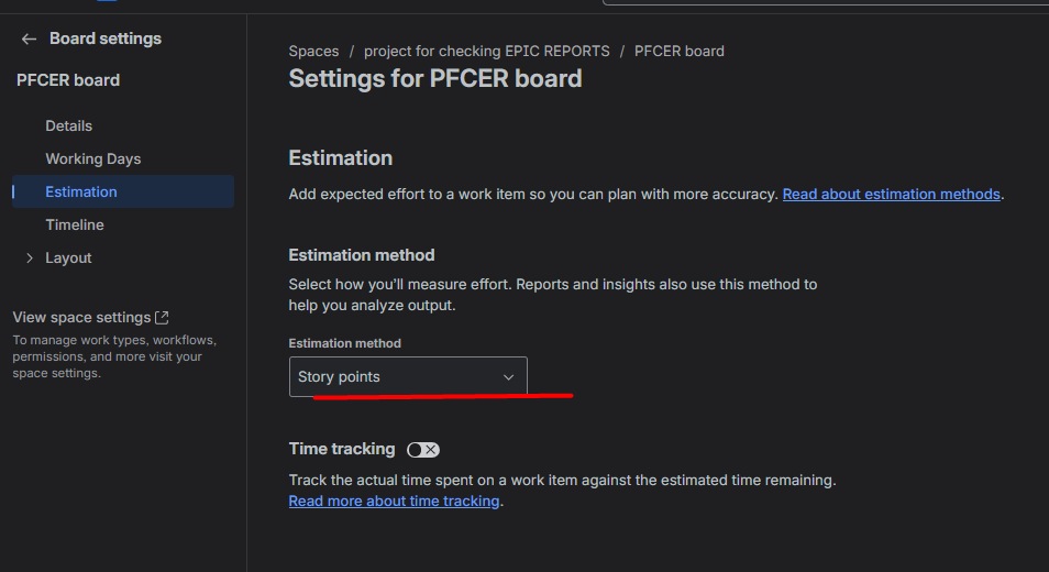

Check the Estimation setting used on the board?

3. "Check the Estimation setting used on the board?"

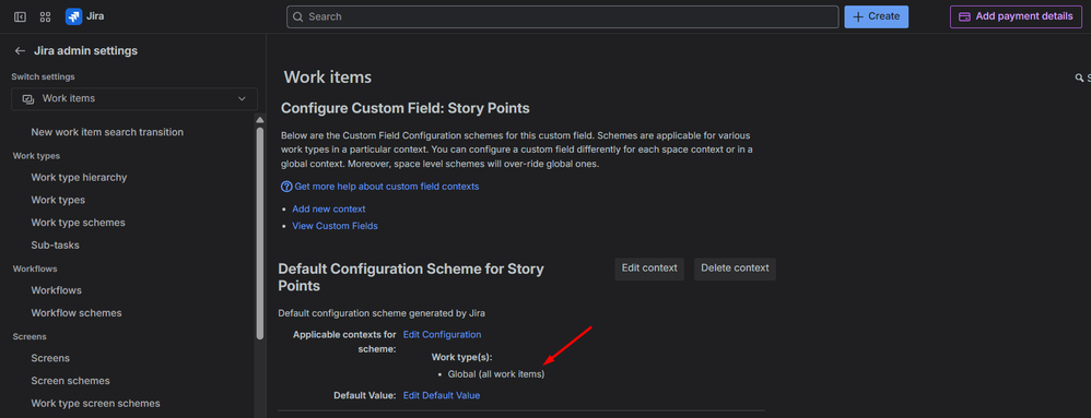

4. "Check if there is a context set for the field, based on issue type or project."

Yes, I can edit the estimation cuz the sprint is active:

"If you go back to the Layout page and search again in the panel on the right for a field named "Story Points", do you find another field by that name?" - no, just one field:
"as @Marc - Devoteam suggested your system probably has two fields named "Story Points" and the wrong one has been included in your screen layout" - I can see just one field, kindly have a look:

"By default, the ā€œStory pointsā€ fields is available only for issues of the following issue types:
  • Story
  • Epic..."
I've added this estimation for all types. Now it works! :)
