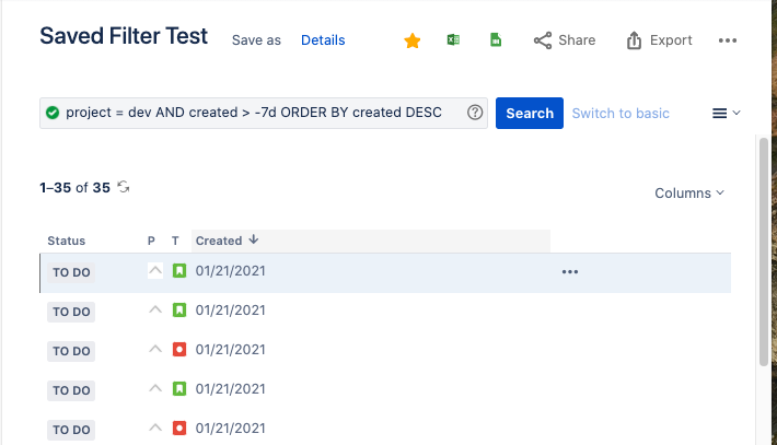

Step 2: In the Advanced Search screen open your saved filter, and switch to List View if you are not already there. Here is an example of a simple filter I saved where Key is not one of the displayed columns.
Notice the button next to the filter name "Saved Filter Test". It is currently labeled "Save As" because no change has been made to the filter yet.

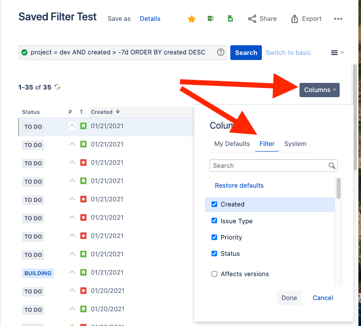

Step 3: Open the Columns selection and make sure the Filter tab is selected.
This should show you a list of all the selected columns that are currently saved with the filter.

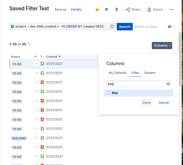

Step 4: In the search field type in Key.

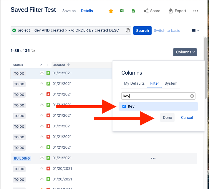

Step 5: Check the box next to Key, and then click on the Done button.
This should add the Key column to your screen as the right-most column. If you have a large set of results. Give it a few moments. If it still hasn't displayed, try clicking the Search button.

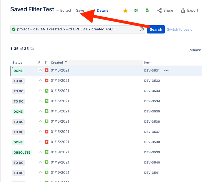

Notice that the Save button next to the filter name still says Save As. Jira doesn't recognize a change to the column selection as a change to the filter, so it is not going to "save" you column selection change with the filter at this point. If you navigated away from this screen and then came back and reloaded the filter, the Key column would not display.
Step 6: Change some aspect of the filter criteria or sort order. I'm changing the sort order from DESC to ASC. Then click the Search button. Notice that the button next to the filter name has now changed to "Save".
Step 7: Save your filter.

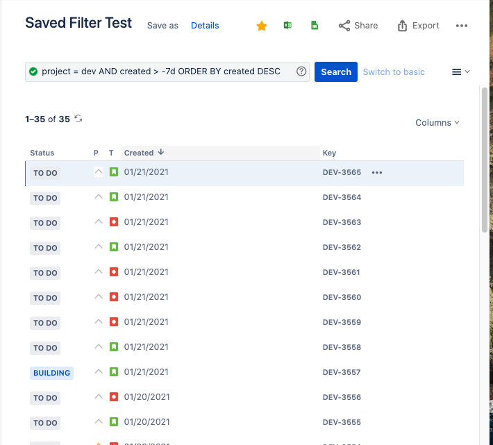

Step 8: You probably don't want to keep this change to your filter, so revert the change you made. I'm changing the sort order from ASC back to DESC. Then click the Search button again.
Your change to the selected Columns should now be saved with the filter. If you navigate away from this screen, then come back and load your saved filter again, the Key column should display.
As to why it may have disappeared from your filter when you think you have not made any changes, I cannot explain.
