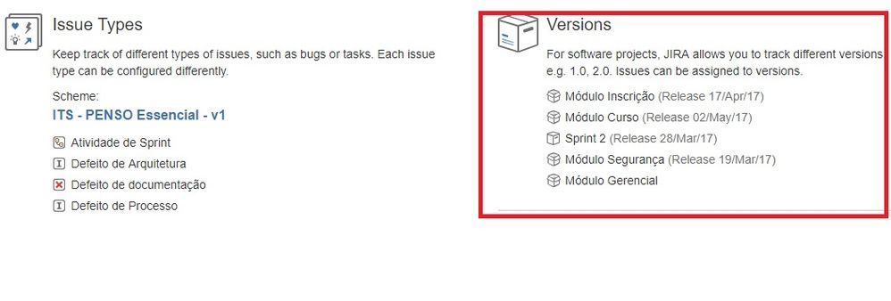

When trying to add a new version to the project, the "new version" button does not appear, but the permission schema is the same as the other projects, and these others are working normally.

It looks like you do not have project administration rights.

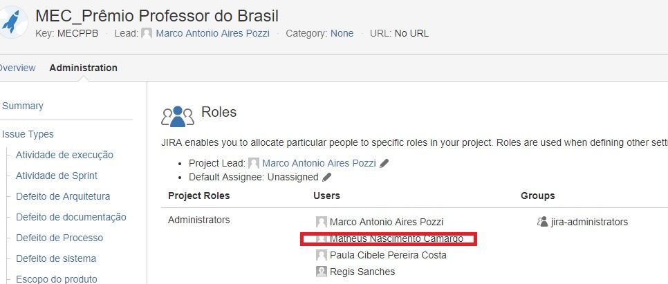

Matheus Camargo
August 14, 2017

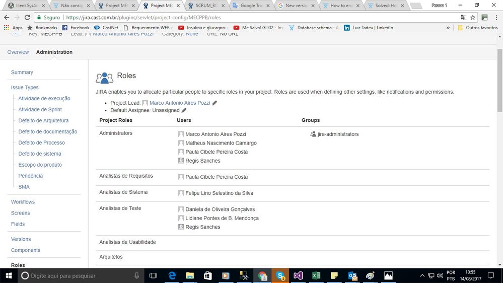

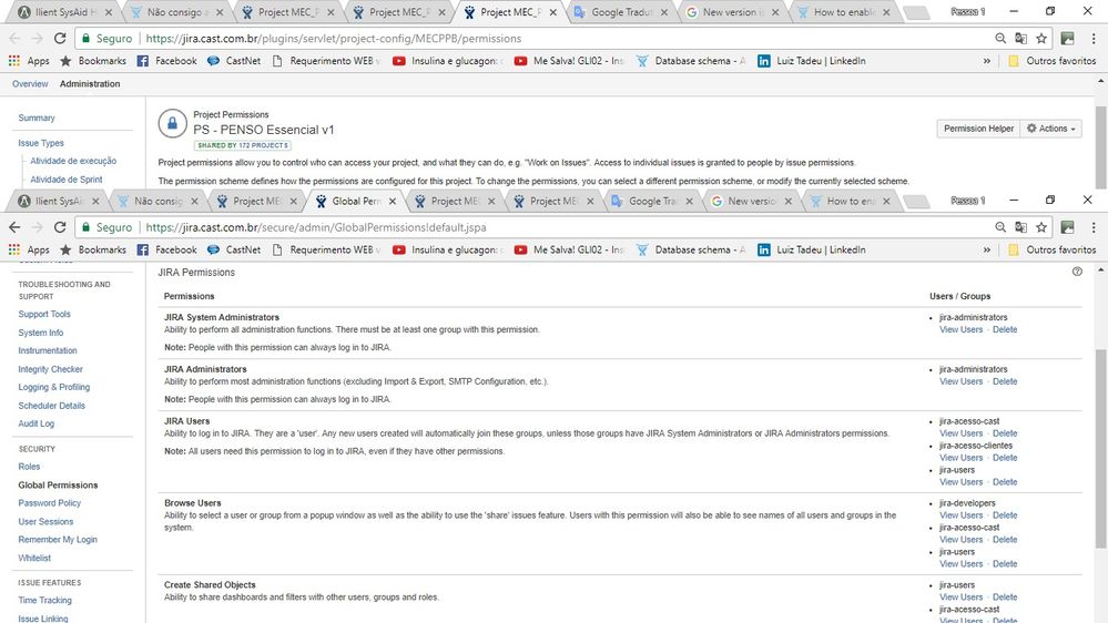

I sent a print of the roles, my user "matheus nascimento camargo" is in the jira-administrator group and with permission in the role of project administrator

Nic Brough -Adaptavist-
August 14, 2017

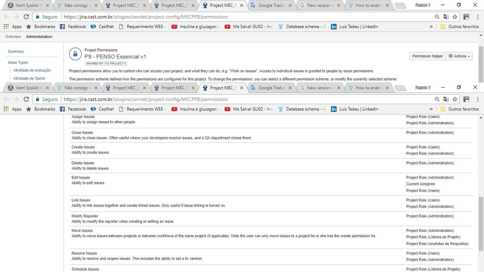

What does the permission scheme for the project say?

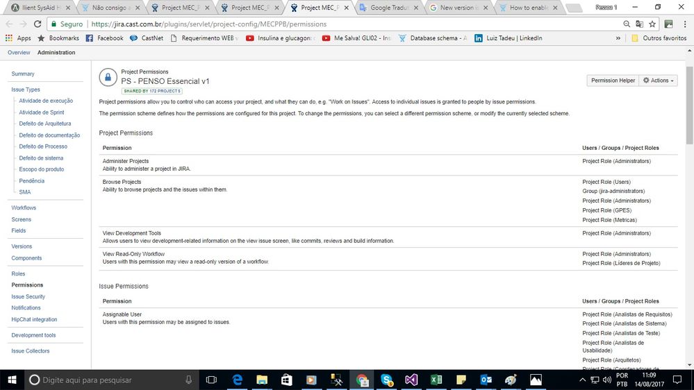

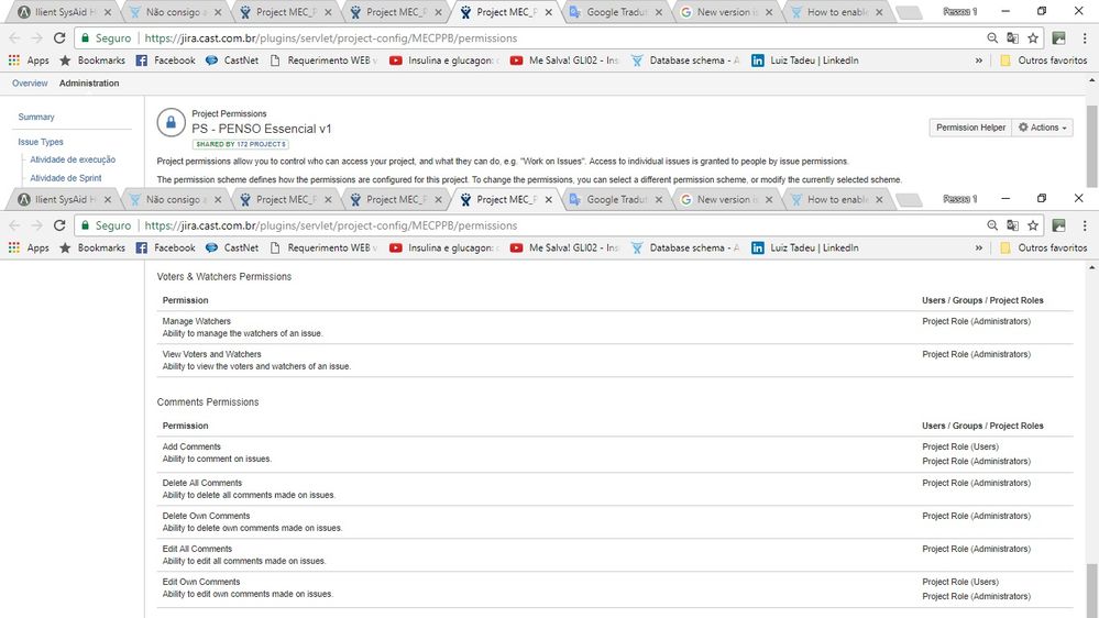

August 14, 2017

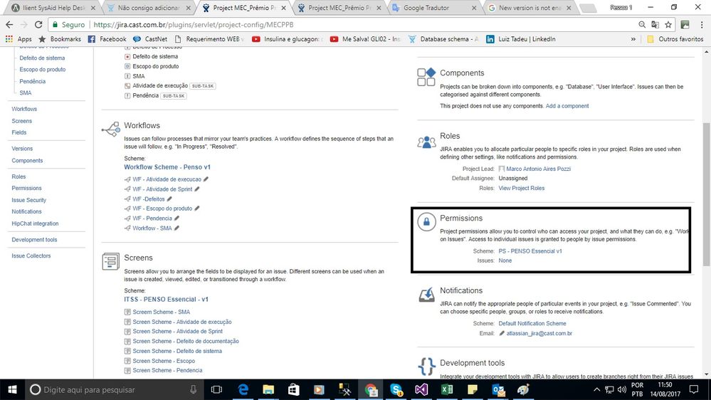

That all looks fine, the only thing not shown is that the project is using that particular permission scheme.
I'd also try the "permission helper" at the top right.
But I doubt it will tell you anything you haven't already checked.  As I said earlier, as this is all correct, it'll need to go to Atlassian.
