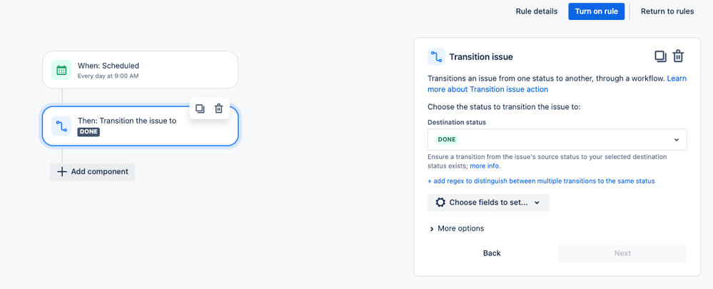

Trudy P Claspill
January 18, 2024
I would recommend you use a Scheduled trigger and run the rule daily.
In the Schedule trigger use this JQL:
project=X and created >= startofday(-15) and created =< endofday(-15) and status=status1
Each day that will get a list of the issues from project X that were created at some time on the date 15 days ago, and that are currently in status1.
Replace X with your project and status1 with the actual name of the status.
Also, make sure to uncheck the box that says "Only include issues that have changed"
Following the Schedule trigger add a Transition Issue action and in it select "status2".
That will transition all the issues found by the JQL to status2.
This assumes that there is a workflow transition between status1 and status2, and the Actor of the Automation rule has permissions in the project to make that transition happen.

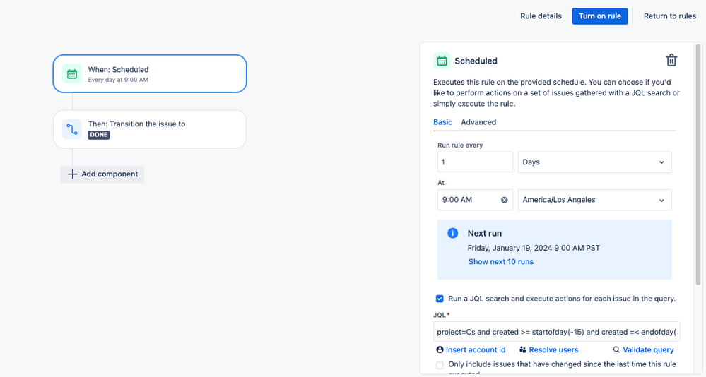

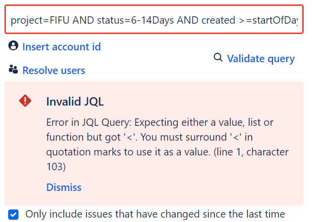

project=FIFU AND status=6-14Days AND created >=startOfDay(-15) AND endofday(-15)  This is what i have but i get the following errcoderror.pngor
Trudy P Claspill
January 18, 2024
You left out some required text:
project=FIFU AND status=6-14Days AND created >=startOfDay(-15) AND created =< endofday(-15)

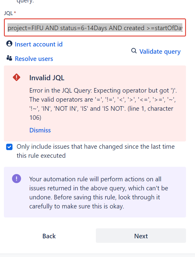

Kelsey Knaus
January 18, 2024
Trudy P Claspill
January 18, 2024
I apologize. There's a typo in what I provided.
Before "endofday" change the =< to <=
project=FIFU AND status=6-14Days AND created >=startOfDay(-15) AND created <= endofday(-15)

Kelsey Knaus
January 19, 2024

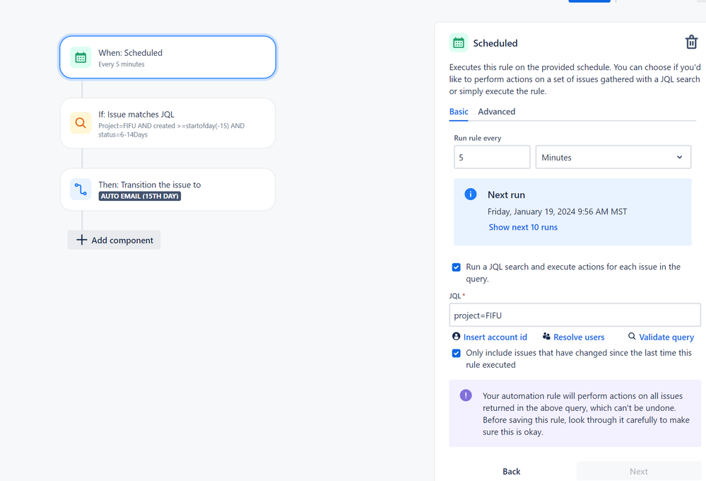

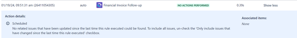

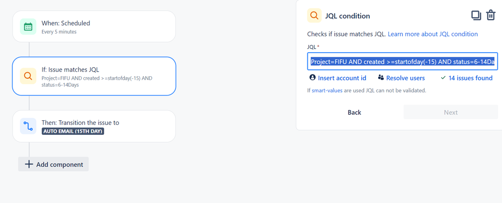

Kelsey Knaus
January 19, 2024
for some reason the action is not performing at all.  It shows there are 14 issues then it should move right?
Kelsey Knaus
January 19, 2024
these are the statuses.  I am trying to get anything thatis 15 days or older to move to the auto emailstatuses.png
Trudy P Claspill
January 19, 2024
As I mentioned in my response where I outlined the steps of the rule, in the Scheduled trigger you need to uncheck the box below the JQL statement, where it says "only include issues that have changed..."
