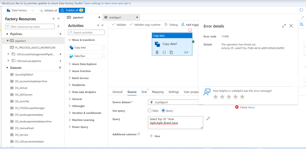

We are trying to extract JIRA data like Issues, Ticket details from ETL tool called Azure Data Factory through JIRA connector, We are successfully created the coonection but tables are not loading it is getting timed out.

I am experiencing a similar issue with my pipeline in Azure. My pipeline is set up to transfer data from Jira to the data lake, and I have used an API token to establish the connection.
However, I am encountering a problem where only one table gets copied successfully while others are not. I have tried using a for loop and a single copy activity, but the other tables are not being copied at all. I have attached some screenshots for reference.
Have any of you encountered this issue before? I would greatly appreciate any insights or advice on how to resolve this.

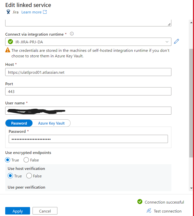

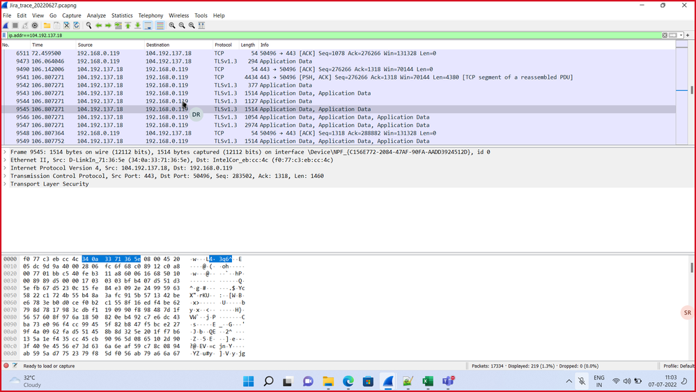

Hey Nic,
Yes, connection is properly configured, we are also trace the connection using wire shark, please check below details, it's application data which is causing issue.image.png Check below jira connection configuration
Nic Brough -Adaptavist-
July 7, 2022
All wireshark is telling us is that it can reach and talk to the other end.
It's not telling us that your connection settings are right or why Azure Data Factory isn't reading the data.
sudhir kumar rai
July 7, 2022
Hey Nic, we have resolved the issue form data factory end, we have checked JIRA URL in postman and its working. Thanks

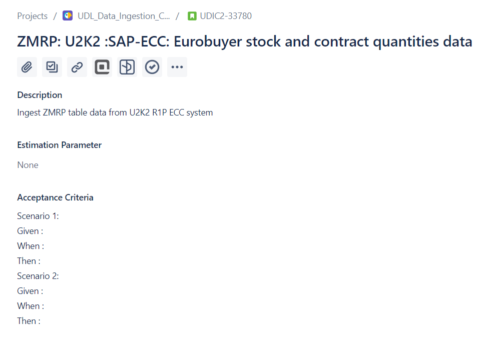

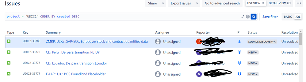

We are trying to explore two option to connect JIRA cloud and extract data using
Azure Data Factory, we have managed to extract data by using query (Select * from "Platform"."Api_Issue") tables,
now we want to go inside ticket UDIC2-33780 and capture the "Description", "Estimation Parameter" and "Acceptance criteria" fileds data, please guide us from which table we can pull the below fields data?
July 28, 2022
You'll need to look at how your Azure Data Factory is storing the data it is extracting over the REST APIs.  I can't tell you what shape it is storing the data in.

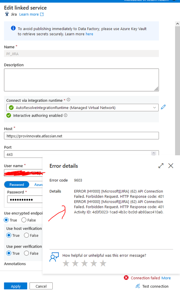

Hello- I'm facing the same issue, can you please share if my Jira user permissions need to have specific configurations to allow connection from Data factory to Jira?
sudhir kumar rai
August 3, 2022
Hi Prateek,
You need to create API token to connect JIRA cloud. Please click on right most icon, in my case SR (Red Marked) is showing, then click on your ICON> Managed Account>Security>Create API Token>copy API token and paste it in linked service password, that's it your connection will be successfulimage.png
Prateek Fulsundar
August 4, 2022
It worked. Thank you !
