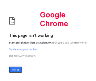

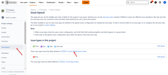

I am receiving the 'The page isn't working right now' when trying to open the Scrum Default Issue screen under Project settings / Issue layout
I tried different browsers, IE Edge & Google Chrome, both the browsers gives the same error, I have cleared the all the browser cookies and caching, the error still persist.

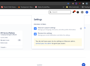

I do not see the setting option, under the gear icon. I have checked with our Jira Admin regarding the type of permission I have, and he confirmed that I have the admin rights, am I missing something.

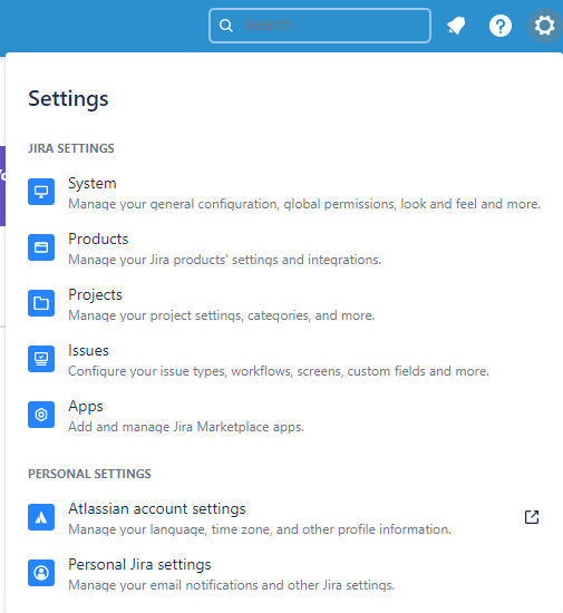

@Pally, Krishna You will need to be a Jira Admin and not just a project admin. If you are a Jira Admin you will see the following. You may need to work with your Jira admin to make changes.
