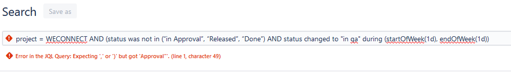

I am quite sure you are missing a closing bracket at the end of your test query. Try this one:
Project = WECONNECT AND (status was not in (“in Approval”, “Released”, “Done”) AND status changed to "in qa" during (startOfWeek(1d), endOfWeek(1d)))Then, I'd recommend you make sure each of the separate queries is tested and works before combining them into the full monty ;-)

But still after correcting the brackets I am getting the exactly same error. :-{
The following query worked for me. Thanks. :-)
project = WECONNECT AND (status was not in ("in Approval", Released, Done) AND status changed to "in qa" during (startOfWeek(1d), endOfWeek(1d)) OR status was not in ("In QA", Released, Done) AND status changed to "in Approval" during (startOfWeek(1d), endOfWeek(1d)) OR status was not in ("In Approval", Released, "In QA") AND status changed to done during (startOfWeek(1d), endOfWeek(1d)) OR status was not in ("In Approval", Done, "In QA") AND status changed to released during (startOfWeek(1d), endOfWeek(1d)) )
