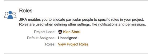

Once you see that, try to navigate to the "Roles" section. This should be on the righthand side of the screen.
In this section, you should be able to see what roles individuals in your project have.
To see this, you need project administration permissions, but this will allow you to see who else has them.

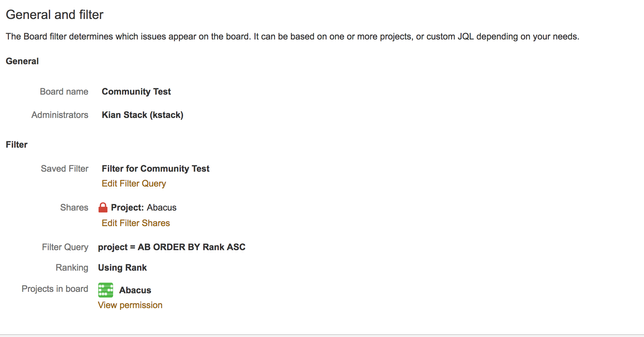

Notice that my board is configured to make use of the ranking. To change your board filter, you should be able to click on "Edit" filter query. By doing that, you can append "ORDER BY Rank ASC" if it is not configured already.

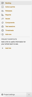

In a the project on the left I found items like: Backlog | Active sprints |... | Settings. I click Settings.

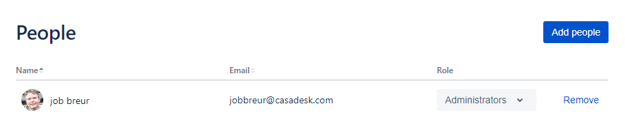

In the left menu I now see items like: Details | People | ... | Permissions. I not find Roles. I click Permissions.

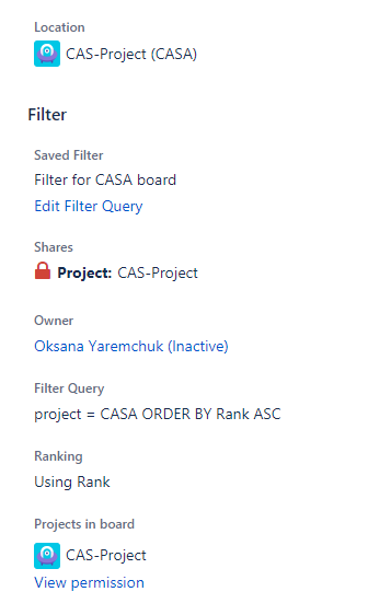

1. Don't know how to determine a Jira project is a scrum project. In the settings of the project I find the project type to be 'Software'. The board title and workflow title has the word 'Scrum' in it. That aside, the project is a scrum project. Meaning we have a shared board with issues and lanes (among other things).

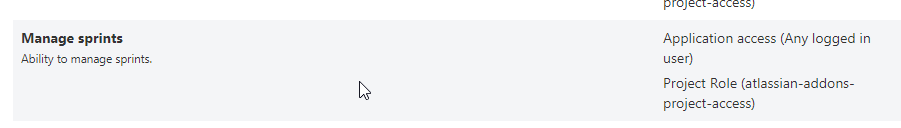

2. In Project | Settings | Permissions I find the following permission details:
So, to me this says any user with application access should be able to create a sprint.

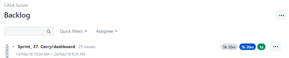

3. As stated the problem is that I do not see the 'Create sprint' button (see image below).
