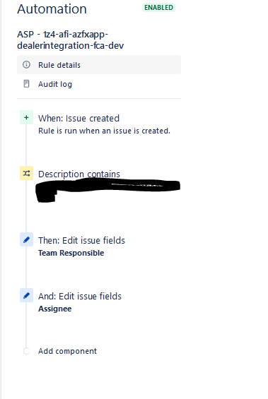

when the issue is created in our HelpDesk Project and contains specific language. It is assigned to another team that is in another project ( Application Support Project). Once the Team responsible has been changed to Application Support Team. It is then assigned to a specific user.
So in essence, the specific language within the HelpDesk ticket kicks the rule off to reassign to the Application Support Project Team and then the specific user (within the Application Support Team).

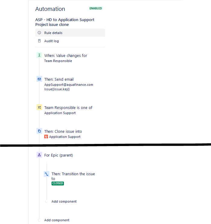

I am trying to transition the parent ticket to close after the ticket is cloned to another project cloned and am getting this error.
Transition issue
Destination status could not be resolved. If using a smart-value ensure this resolves to a numeric status ID or untranslated name for issues (with current status):
HD-42859 (Open - 1)

There are quite a few rules that are similar to the one below. If certain criteria is present the rule, assigns to a specific Team and Assignee.
This is the rule that then Clones the above ticket to another project. What I am trying to accomplish, is to close the parent ticket after it's been cloned.
Here is the error that I am getting.

As far as I got it right you would like to to close the original issue so to say:
  • issue A in project A —> cloned to issue B in project B
  • then close issue A
There is a difference between parent epic and original/source issue. If my assumption above is correct your branch is trying to close the epic of the original issue. To close the original issue (in the example that would be issue A) leave out the parent branch and just do the transition to closed as the issue A is already in the context of the automation rule.

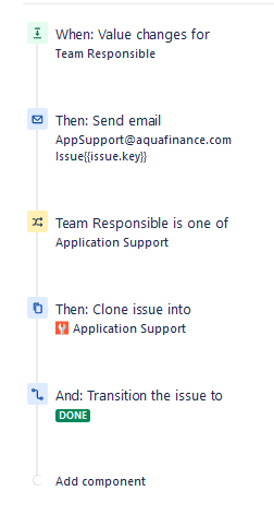

So when I've changed the rule to the below, it still will not close ticket A.

Here is the output in the log file.
Send email
Successfully sent email for issues (with message ids):
HD-42896 (da891fb9-f421-4917-b0d8-853c1b22f42a)
Issue condition
The following issues passed:
HD-42896
Clone issue
Issues cloned successfully
ASP-3638
Transition issue
HD-42896 (Open - 1)
Stefan Salzl
March 24, 2022
seems like a workflow issue:
Does the status "Resolved" exist in that special workflow, for within this project and the issue type you would like to transition?
In some posts above that shows a screenshot it was closed. In this rule it´s resolved. Please check your workflow and be sure to which status you would like to transition.

I've tried this with both statuses and I get the same error for both.
Stefan Salzl
March 24, 2022
What does your workflow look like? In which status is your issue that you would like to transition? Does the workflow allow a transition from the "current" status to the required status? Is there any validation or screen configured in the workflow for that transition?
Robert L. Nowitzke
March 25, 2022
I was able to finally get it to work. I had to have the automation acknowledge that the ticket was in 'open" status first and then it was able to transition it to a done status. Thank you for all of your help! Much appreciated.
