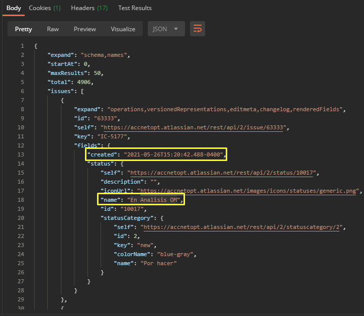

I'm new using the JIRA API and i have the following situation.
The problem (1):
I am trying to filter between two dates but the response is showing results out of range.
The problem (2): I am trying to filter by "issues>fields>name" between two words, but as the problem 1, the response is showing results out of "range".
This is my query:
https://accnetopt.atlassian.net/rest/api/2/search?jql=project=IC+order+by+duedate&fields=id,key,status,created&jql=created%20>=%202021-05-17%20AND%20created%20<=%202021-05-23&status.name=%20Listo%20&status.name=%En Analisis RM%20
This is my result: bug.png
Any help dudes?

Hi @Alex Sebastián Oyazún Figueroa  -- Welcome to the Atlassian Community!
It appears you are concatenating multiple JQL statements in that call.  Why not just do the JQL all at once?  That may rule out any query result issues.
project = IC AND created >= "2021-05-17" AND created <= "2021-05-23" AND status = "En Analisis RM" ORDER BY duedate
