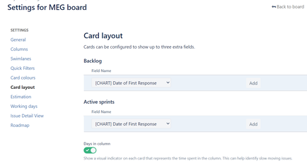

You can choose the time spent on ticket's by navigating to Board settings>> Card layout>> enable Days in column. Screen shot inline.
With the new Jira software updates, this feature might work or not. If not, then the only option I see is to send a request to Atlassian support for alternate steps or work around.

I'm not able to see the card layout settings in my UI... I'll have to ask my sys admin to see if I need more permissions.
