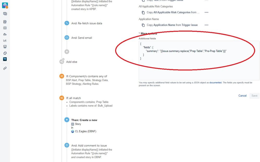

I am using a rule to create a new story in another project, when the originating story is marked "done". I am trying to replace words in the title (summary) with alternate words using the following json code in the "additional fields" section of "create issue" action:
{"fields": {"summary": "{{issue.summary.replace("Prep Table","Pre-Prep Table").replace("Monitored Population","Pre-Prep Table")}}"}}
Essentially if the title has "Prep Table" within it, I want that changed to "Pre-Prep Table".
This syntax works in other areas with different words, but it errors on this one. Is there a way to do this or any clue why this causes an error? "Error while parsing additional fields. Not valid JSON" (the error message)

The syntax works for me when I use it in a rule.
"fields": {
"summary": "{{issue.summary.replace("Prep Table","Pre-Prep Table")}}"
Do you have any other Advanced Edit functions in your rule? Perhaps the error message is referring to a different one. Can you show us the audit log and a full list of the components of the rule?

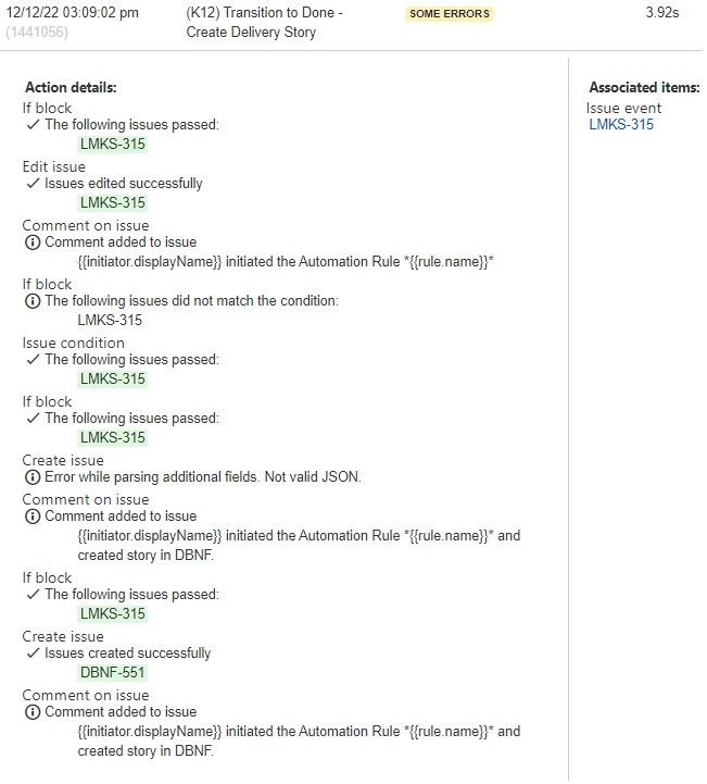

Other than being extremely lengthy, it's pretty straightforward. The error points to that exact JSON, but maybe I'm missing something. Here is the audit log with the error and the long components list.JSON Error Audit Log.jpgJSON Error (all components).jpg
Trudy Claspill
December 13, 2022
If I am reading the audit log correctly, it seems that the problem is arising in the fourth IF block (noting that the third IF block is not an actual block that includes actions). Is that correct from your perspective?
And the JSON you are using is being used in a Create Issue action, correct?
And you are trying to set the Summary of the newly created issue to match the Summary of the triggering issue, but with text replaced. Correct?

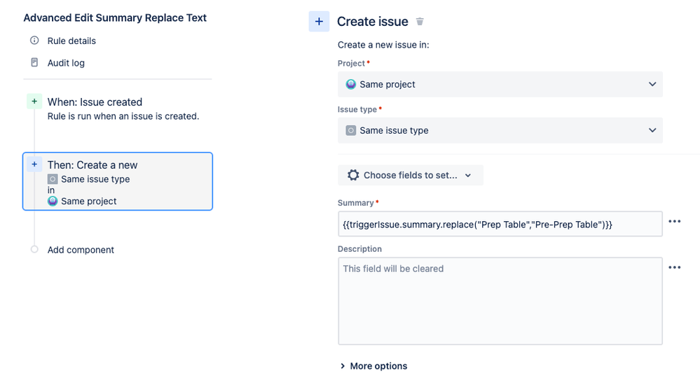

If the above is correct, then you can simply set the Summary field using a smart value directly, without using Advanced Edit
{{triggerIssue.summary.replace("Prep Table","Pre-Prep Table")}}

In which case single quotes should be tried for surrounding the text values that will get replaced.

It's always the simplest of solutions that I can never come up with. Thanks, that works for now (in UAT), so I'm hoping it works correctly in Production. The advanced edit before also worked in UAT but not Prod, so if this doesn't work then there's a discrepancy between our UAT and Prod.

Your suggestion worked and was even easier to understand for future maintenance, so thank you!
