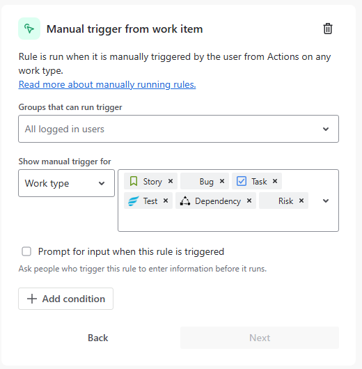

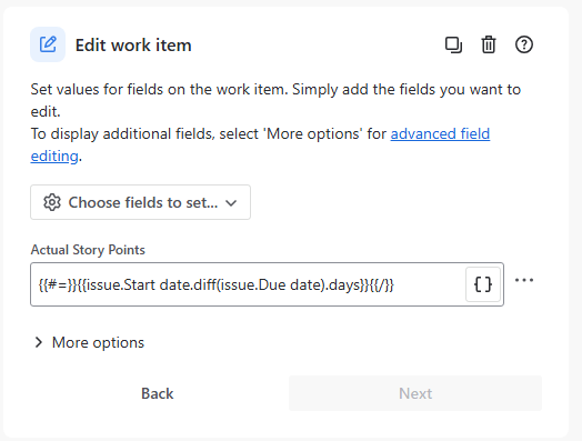

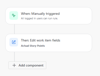

  2. Automation Rule Automation Rule.pngAutomation Trigger.pngAutomation Edit.png

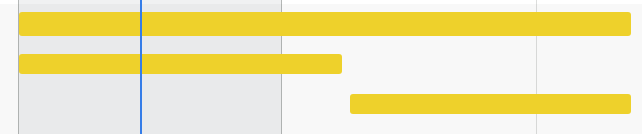

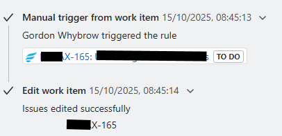

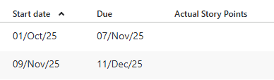

The issue is that the field "Actual Story Points" is not being set. Actual Story points is a custom field that does get set if the formula calculates from now to Due date, but when Start date is used this results in an empty value. It could be that the formula is picking up the wrong "Start date". Does the one populated in the timeline have a different name for use in formula?

I suspect that there are multiple custom fields called Start Date in your instance.
Check the fields section un der the admins section work items, if there are multiple fields, get the custom field id from the correct field and then adjust the smart value by using
issue.customfield_xxxxx instead of issue.Start date (where xxxxx is the id of the custom field)
Gordon Whybrow
October 15, 2025
Hi @Marc -Devoteam-
Thank you, that worked!
