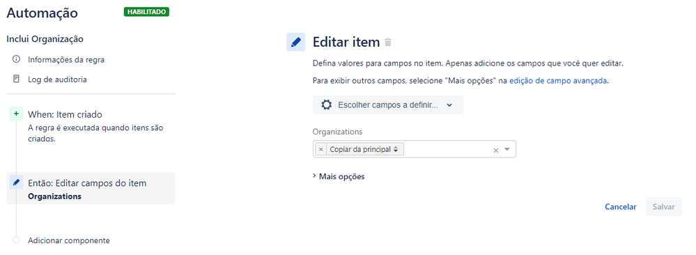

When I receive asks in Jira Service Management and I need that our devs work in the case, I create a task in Jira software to them.
However, I must to sum each hour worked to billing my customers.
I don't know how to do this, because the Jira Software does not let me input Organizations. Watch this video.
I already created an automation, but didn't work.
You got it?
Thank you for your attention.

The Organizations field is only set to use in Jira Service Management!
The workaround option is we can have a custom field for Organization in JSW as it does not allow the Organization field to be used in JSW. This came to my mind since you are managing the issues, it's one more field to fill in.
