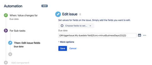

Hey there,
That rule looks good, the main thing here is to make sure that the date fields are available and visible on the subtasks. Can you manually edit these fields on the subtasks?
Can you attach a screenshot of the config for the "Edit issue" action so we can take a closer look? If there's sensitive info on it, you can raise a private support case at https://codebarrel.atlassian.net/servicedesk/customer/portal/1
Ideally, I would like to make some due 30/Jan/18, as they need to be done a bit ahead of other tasks.
For actions on adjusting the dates, see: https://docs.codebarrel.io/automation/smart-fields/working-with-dates.html
In your case you'll want to use minusDays or minusBusinessDays to set the time to be in the past. Your rule will look something like:
Where your custom due date should be set to (replace "Insert your duedate field name here" with your field name)
{{#triggerIssue.Insert your duedate field name here}}func=minusBusinessDays(2){{/}}
Hope that helps and let us know how you go!
