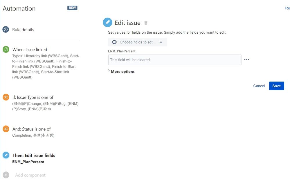

I want to make an automation rule like below.
when : issue linked
condition 1 : linked issue type id = 10511, 10612, 10603
condition 2 : linked id = 10309, 10703
condition 3 : linked issue status = completion
issue edit : (number of condition1 & condition2 & condition3) / (total number of condition1) x 100
How can I do that?

Hi @jun lee
Perhaps to re-frame the question: what problem are you trying to solve by doing this?  Knowing that may help the community to offer suggestions.  Until you share that information...
With Jira Server/Data Center, I believe you will need to experiment to determine if this is possible.  The reason I suggest that is...
  • Jira Server/Data Center automation does not have the action Create Variable, and so you will need to either perform this in a single edit action, or repeatedly test your conditions and then store the intermediate results in custom fields, followed by re-fetch actions, for later calculation.
  • Testing the link types may not be possible in a rule, as I do not believe smart value, list filtering is available for Server/Data Center automation.  You may discover a way to do this with bulk-handling with a branch.
  • Your third condition may be a challenge, as it appears to be testing the status of the issues which are linked.  I do not know how much data Jira loads for each linked issue within the rule.  It obviously does not load *all of it*, or a single issue could drag in an entire Jira instance through a chain of links.  You will need to test if the linked issue status values are even available to test.
Kind regards,
Bill
jun lee
February 19, 2023
Hi
Ultimately, I want to calculate the progress percent as (number of condition1 & condition2 & condition3) / (total number of condition1) x 100 to the Gantt Chart. I thought that the automation rules could be the solution.
If you know another solution, let me know.
Thanks.
Bill Sheboy
February 19, 2023
Thanks for the additional details.  I do not believe that would be possible with the built-in features.

Hi @jun lee
You have to be a bit more thorough about your rule. I'll give you an example:
  • Trigger: Issue linked
  • Condition: If issue type of linked issue is ANY (or ALL) of 10511, 10612, 10603
  • Condition: If the link type id is 10309 or 10703
  • Condition: If the status of the linked issue is "Completion"
  • Action: Edit issue -> Which field is to edit? Which numbers are going to be placed on that expression of yours? (number of condition1 & condition2 & condition3) / (total number of condition1) x 100
jun lee
February 19, 2023
Hi
I can configure trigger and conditions like attached file, I want to know how to set (number of condition1 & condition2 & condition3) / (total number of condition1) x 100 to the custome field. I want to calculate and update field.
How to calculate (number of condition1 & condition2 & condition3) / (total number of condition1) x 100?
If it is not possible, can I calculate (number of completed linked issue) / (total linked issue)  x 100 ?
