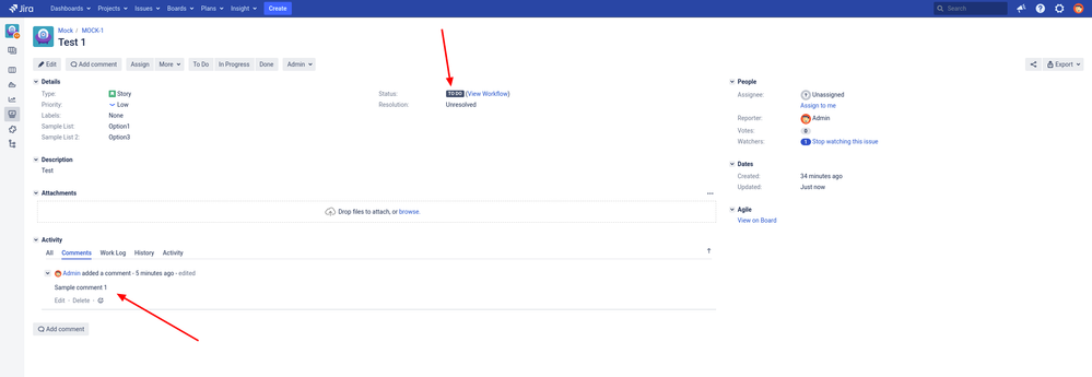

Below are a few print screens for your reference:-
1. First, an issue is created, and a comment is added to it. It is still in the To Do status.
2. Once the issue transitions to the In Progress status, the last comment is updated with the additional text as shown below:-
I hope this helps to solve your question. :)
