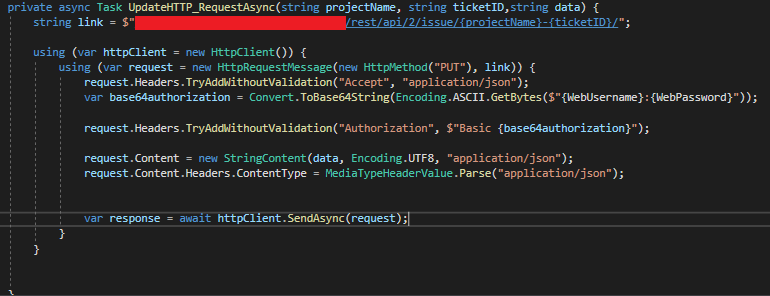

To be more concrete now, this is how it looks like:
This is my actual code:

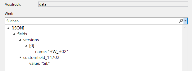

And my json-string which is in data looks like this:
I am 100% sure that these version names and values exist, because I can create the tickets with these values. But changing the fields doesn't work. It keeps on staying the old values/names for the fields above.

1. Have you confirmed that the C# code is correct? IE, can you use that code to update just the value of customfield_14702, or to set some other Jira setting like the assignee?
2. Have you confirmed the JSON data of the request is valid? IE, can you can use that same JSON data in a REST API test tool like Postman to set the field values?
3. Have you tried putting the JSON data directly into the code not a variable? IE, does the request work if don't have it stored as a variable, but as a string typed directly in the code?
In your variable 'data' you have started with an outer array called '[JSON]' ... what is the purpose of that?

The variable data doesn't have another array [JSON]. In Debug-Mode I can chose how to view the data e.g. as string, as HTML or as JSON. The string form starts with something like {\fields\: etc...

What is really strange - the return code 200. This should not be possible, even if you send empty body. So I suspect, that the PUT method is not set correctly and instead of it GET is used (or something like this).
I'm not C# developer, but I googled this a little bit and usually the request in the scripts I found has been defined like this:
var request = new HttpRequestMessage(HttpMethod.Put, link)Would you please try it?
If you want to update Fix Version/s field, the request body should look like this:
"fields": {
"fixVersions": [{"name": "1.0"}]
}So I think "versions" should be replaced by "fixVersions".

The customfield_14702 is single choice from a list. I think thats not the issue though, as it works like this when I create tickets.
versions and fixVersions are two different fields actually and they both exist. Similar to the customfield_14702 I created a ticket with versions, so that also should be correct I think. Especially because versions is a mandetory field when creating tickets.

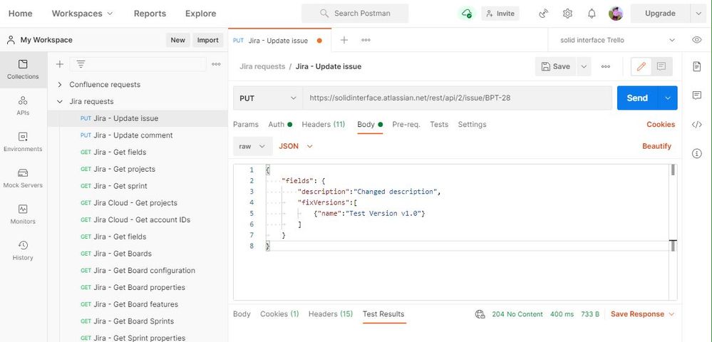

I just used Postman to try updating some fields in an existing issue by doing a PUT request to the same Jira Cloud REST API v2 endpoint you've tried and it worked fine, and I got the expected '204 No Content' response:
When I tried the same request with no JSON in the body of the request, I got the expected '400 Bad Request' response. When I tried the same request with faulty credentials, I got the expected '401 Unauthorized' response.
