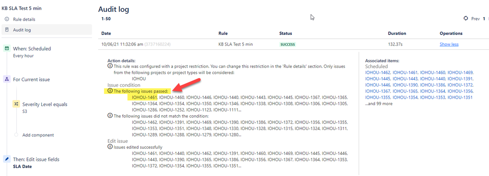

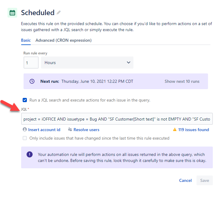

@Trudy P Claspill , so I do have the JQL on the schedule step, and it shows 119 issues found.

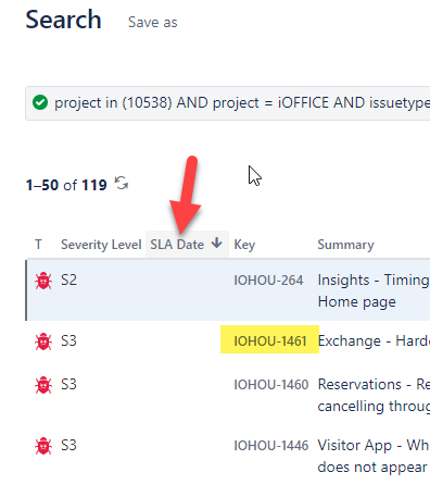

The audit appears to show that it was successful, now. However, the values are not showing up in my query when I add the "SLA Date" field as a column.
I have this field hidden on the bug issue screen, but I should be able to see the value in a filter. At least it works that way on my auto rule when creating an issue. On that rule, I don't use "Scheduled" I use the "When: Issue created" trigger. And that shows the value in the SLA Date value in the SLA Date column on the filter correctly, but on that one, I use {{now.plusBusinessDays(3)}} - not sure how this is different.

As an FYI for your rule with a scheduled trigger on JQL, automation rules can only process up to 100 issues per execution.  You noted that when you ran/tested the JQL it returned 119 issues.
Something to watch for in the future as such a rule could take a few executions to complete all the work, processing in chunks when your JQL supports it.  For example, only looking for issues where the SLA Date IS EMPTY.

Thanks, @Bill Sheboy ! I had to modify my JQL to return less than 100 and it's working now.  Thank you!!
