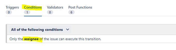

Could it be, that in your permission scheme is something like that Current assignee has the Browse Projects/Transition Issues permission or there's conditions at your transition, that only assignee can perform this transition?

It turns out that there are Workflow conditions for transition, that only the Assignee can change it.
Will ask Jira administrator to add condition for Jira Integration User.
