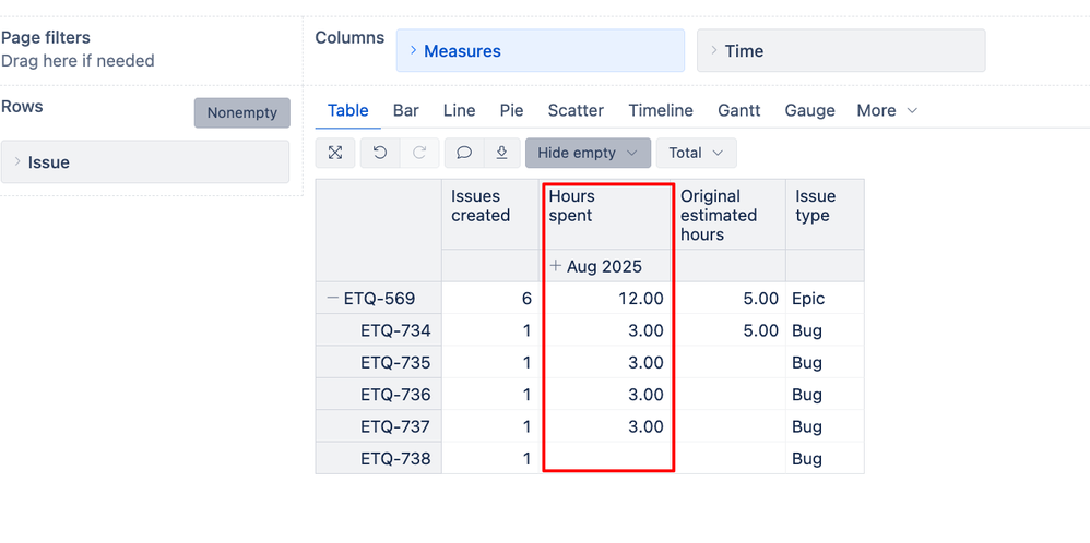

Hi All,
We are looking for options to check how much effort in one epic or story has been spent for a month. We do know that there's a field called time tracking in additional fields section, but we don't know how to put that tracking month wise.

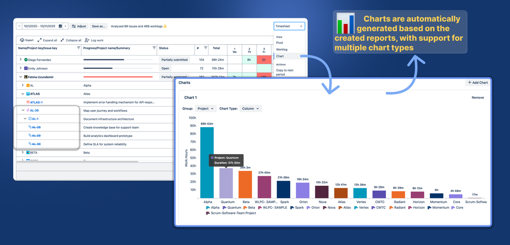

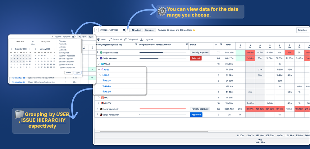

⏱️ Flexible Time Period Reporting
You can generate reports for any time period you need — not just monthly. It supports
  • Daily, weekly, and monthly periods
  • Current or previous period presets
  • Sprint dates
  • Any custom date range
This means you can instantly see how much work was logged on a specific epic or story within a given month, and filter or group results by user or issue.
📊 Epic-Level Visibility with Custom Fields
WLPC lets you group reports by user + issue hierarchy, making it easy to see time rolled up at the epic level. It also adds its own columns — Total Time Spent, Total Remaining Estimate, and Total Original Estimate — for deeper analysis.

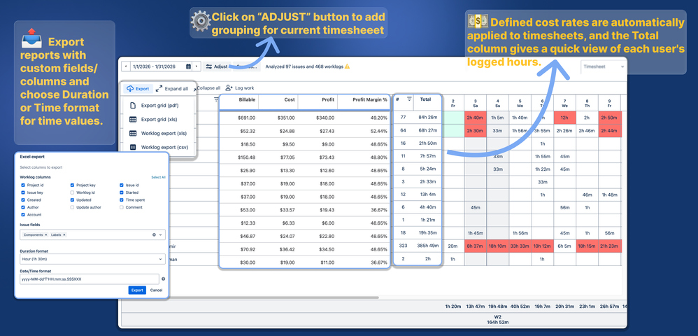

💰 Labor Cost Tracking
If cost visibility matters, WLPC supports billable/non-billable tracking, user and project-based cost reports, and timesheet monitoring. Reports are exportable to Excel/CSV, and access is permission-based so managers can view what they need without exposing unnecessary data.

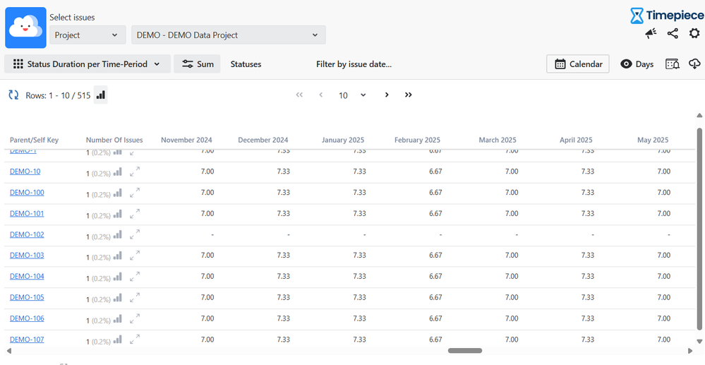

When tracking "effort," it is important to first distinguish between manually entered worklogs (timesheets) and the actual elapsed time an issue actively spends in progress. If you are looking to track the actual elapsed duration automatically rather than relying on manual time entry, native Jira does not easily break this down month-by-month.
If you are open to using a Marketplace app, you can easily track this exact monthly breakdown using Timepiece - Time in Status for Jira.
Here is how you can set it up to track your Epic and Story effort month-wise:
Monthly Breakdown: You can use the Status Duration per Time-Period report. By configuring the time-period to "Month", this report automatically splits the total time your issues spend in active workflow statuses into separate monthly columns.
Roll-up to the Epic Level: To see the total aggregated effort for an Epic, change the report option to a Sum report.
Then, use the Group By option and select the Parent / Self Key field. This will automatically calculate the total durations of all child tasks and roll them up into a single row for the parent Epic.
True Business Time: You can also apply Timepiece's Custom Calendars to your report to automatically exclude weekends, nights, and public holidays. This ensures that the effort you track only reflects your team's actual business hours rather than raw 24/7 calendar time.
You can find Timepiece - Time in Status for Jira on the Atlassian Marketplace. Full disclosure, I'm on the team that makes Timepiece. Hope this helps you get the exact monthly visibility you need.

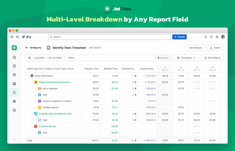

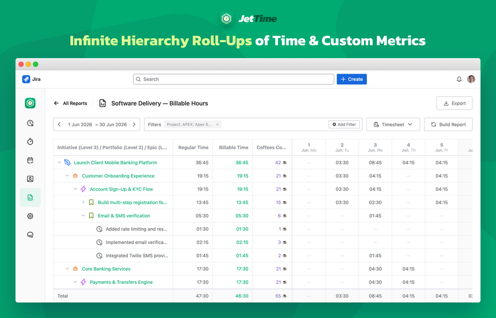

Native Jira time tracking only keeps one running total per issue — there's no built-in way to slice that logged time by month, or to see a month-by-month view across an epic and its stories.
That's the gap JetTime (a third-party Jira app) fills — you build a report, group it by Parent, and break the logged time down by month, so you can see how much effort each epic or story took in a given period.
  • Timesheet view with a monthly breakdown (also day / week / quarter)
  • Group by Parent to roll story time up under its epic
  • Filter by date range, project, user, or a saved Jira filter
  • Export to PDF, Excel, or CSV
  • Runs on Atlassian — your data stays inside Atlassian Cloud, we don't have access
One thing to be clear about for today: grouping rolls time up by an issue's direct parent — so stories roll up to their epic, but work logged further down (e.g. on subtasks) rolls up to its own immediate parent, not all the way to the epic. The good news: we're shipping full roll-up of all child levels this week, which removes that single-level limit — so a month-wise total for an epic will include every nested issue underneath it.
