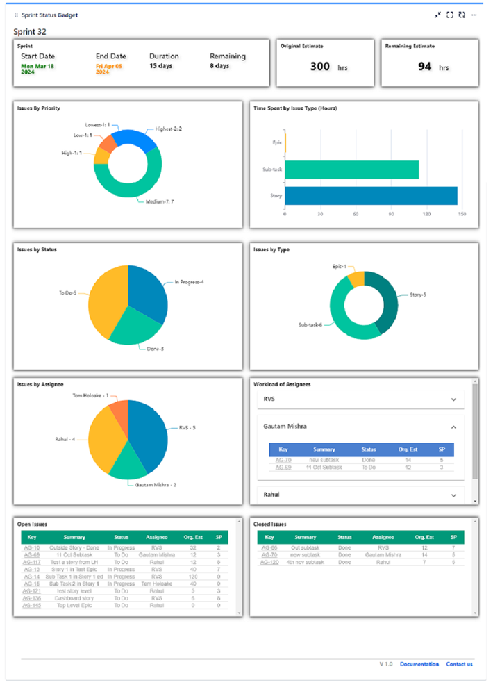

If you are looking to get an overview of your sprint progress and are willing to try out a mktplace app, take a look at
Agile Velocity & Sprint Status Gadgets
The Sprint Status gadget gives a complete summary of your sprint progress with multiple widgets.
The app comes with few other dashboard gadgets to track team member's / team's velocity / productivity based on story points / time spent / issue count in a sprint  and also track sprint status with multiple parameters.
Disclaimer : I am part of the team which developed this app

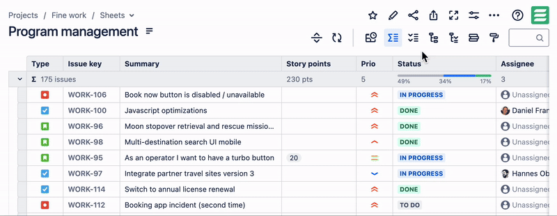

If you're open to a solution from the Atlassian Marketplace, the app my team works on — JXL for Jira — is built exactly for this kind of aggregated reporting.
JXL is a spreadsheet-style view for Jira issues. Its sum-ups feature aggregates any numeric field — including Story Points — across hierarchy levels and groupings. For your use case you could, for example:
  • Group issues by Sprint and see total/done/remaining story points per sprint at a glance
  • Group by Epic to show progress across the backlog
  • Combine both to get a two-level breakdown in one sheet
The sheet can also be added as a gadget on any Jira dashboard, so your leadership view stays in Jira.
Disclosure: I work for the team that builds JXL.

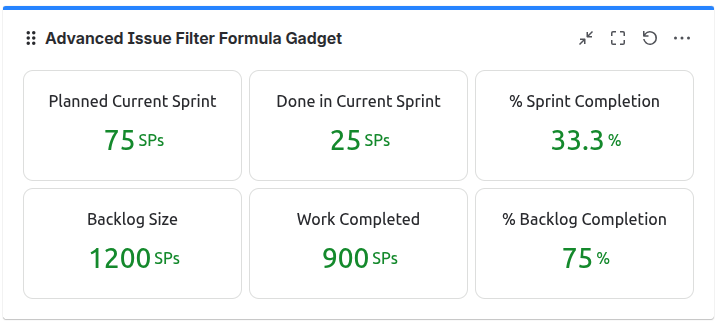

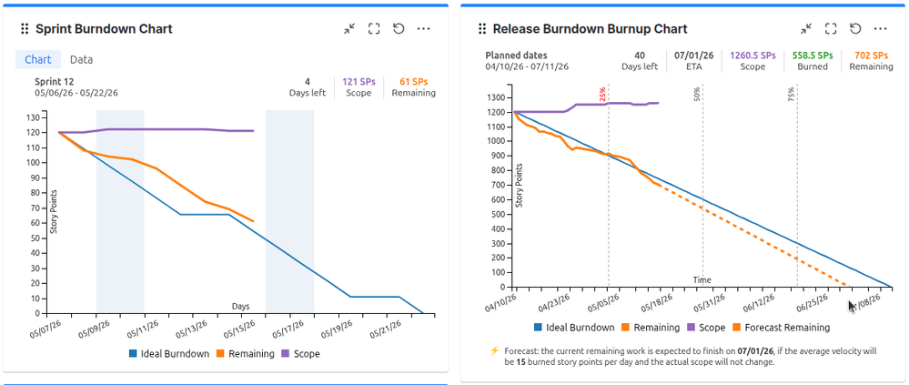

If you'd like to try such a solution, our Great Gadgets app provides everything needed for this use case.
Your reporting need for "the work done vs the remaining/planned work (w.r.t. Sprints & Product Backlog)" can be measured by using its gadgets Sprint Burndown Burnup Chart  (as for sprint level) and Release Burndown Burnup Chart (at release, backlog level).

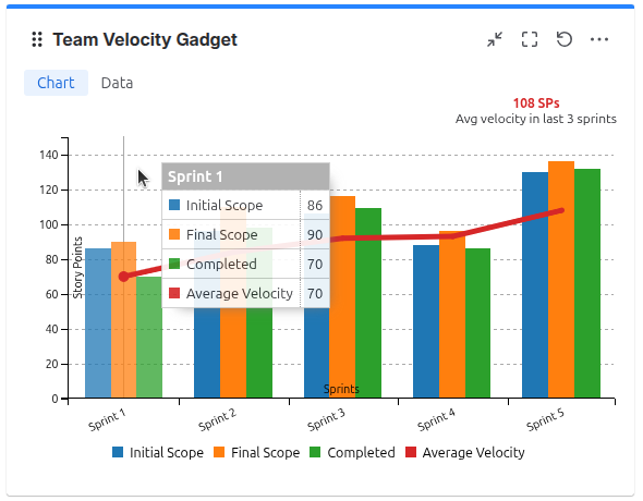

Very helpful for tracking "the work done vs the remaining/planned work" along the sprints is the Team Velocity gadget
If you prefer a more custom way to calculate sum of story points, these gadgets are the solution:

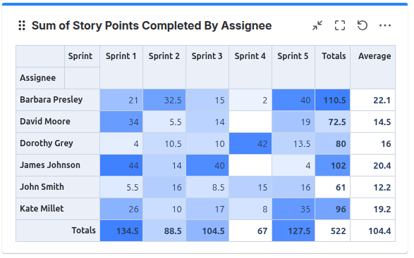

Advanced Issue Filter Formula gadget - it allows applying from simple (SUM, COUNT, AVG) to complex math formulas to issue fields (such as story points) from multple filters.
Pivot Table & Pivot Chart - it allows displaying multi-dimensional stats based on sum of a field (such as Story Points) just like pivot tables in Excel.
These are the type of charts you need for an effective leadership dashboard, and I'm afraid they cannot be generated just by calculating the sum of story points via automation...

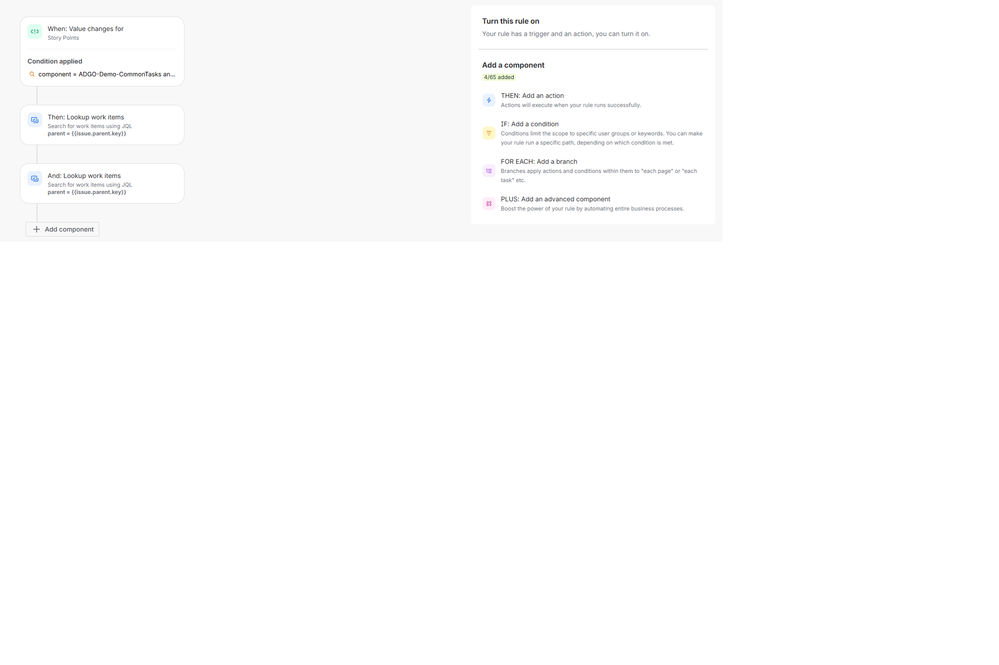

You would need an automation rule here:
  • Trigger: Field change for Story Points
  • Condition: Issue type equals Sub-tasks
  • Action: Lookup issues with query parent = {{issue.parent.key}}
  • Action: Edit issue - parent, field - story points, value - {{lookupIssues.Story Points.sum}}
Tanvi Sharma
May 14, 2026
Thanks for the inputs.
Can you please explain the last Action - how to add all these details?
As of now, this is what I have created:
