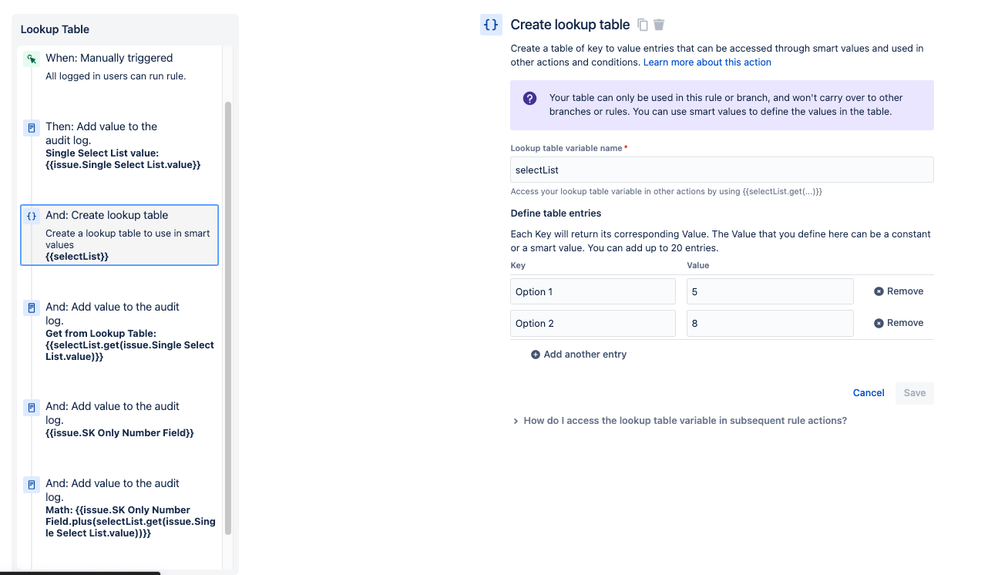

Just did some experimenting with this.
If your custom field (i.e. T-shirt Size) is a selection list then you need to use issue.T-shirt Size.value to get the text value displayed in the field.
If the number field you are trying to set has no value in it yet, not even 0, then this doesn't work.
{{issue.T-shirt Estimation.plus(tshirtSize.get(issue.T-shirt Size.value))}}
It seems that a number field must have some numeric value in it in order for the plus function to work.
I used just Log actions to print values into the log rather than actually updating the issue.
For your use case substitute:
Single Select List >> T-shirt Size
SK Only Number Field >> T-shirt Estimation
