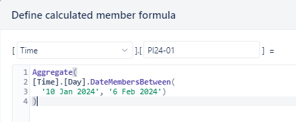

I am importing data from an external source (API) and creating a dashboard from it. I created a time dimension (Aggregate by days).
Now I want to create a calculated measure, that would give a value of 3.25/8 in time level (under the PI level) and the sum over the day in PI level.
So for example for PI level it would be 6.5/8 and for the days under it, it would be 3.25/8.
I was trying this formula but it does not work :

When I do your formula, the days are not under their corresponding PI anymore hence the sum is not displayed at PI level.
Do you know how to fix that ? Thank you so much :)

sikimimi
May 24, 2024
Hello,
I created individual members in the Time Dimension by aggregating the date into PIs. (Screenshot above). So I did not set any hierarchy between the members.
Thanks for your help :)
