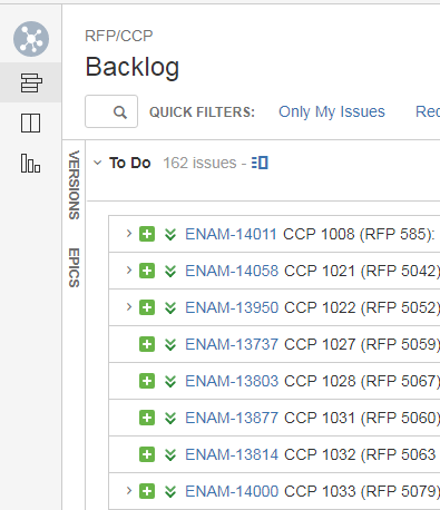

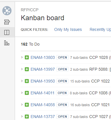

We created a kanban board and now want to be able to sort based on summary. This does work for the kanban backlog, but not for the board itself?

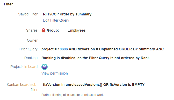

We have a query set up (see screenshot below) but it does not reflect in the board itself (see first screenshot in my opening post, but only in the backlog overview (second screenshot).
Nguyen Tran
March 26, 2018
I think it's because your board's filter is showing sub-task so the Sub-task's summary is also getting sorted.

Yes try edit your Filter Query to
project = 10303 AND fixVersion = Unplanned and issuetype != Sub-task ORDER BY summary ASC
