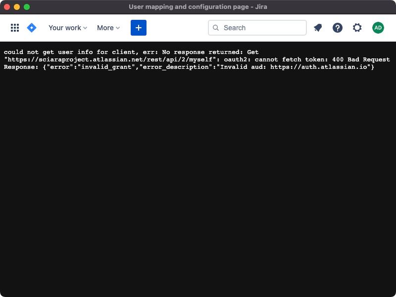

demsi
June 8, 2023
We are experiencing exactly the same. Slight difference: We are not logging in other than with username/password.
The browser that is opening already has an active session. The opposite was tested as well.
this is what it looks like:
