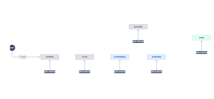

Edward Dighe
January 17, 2023
Hi John,
I hear what you're saying about statuses (see current workflow attached). The problem appears to be that issues can have any of these statuses and also be in the backlog. This is also what stops me from being able to transition any issues with an automation, i can transition to another status but the issue remains in the backlog.

John Funk
January 17, 2023
Ah, so it sounds like there are multiple statuses mapped to the Backlog section of your board. I thought you were talking about an actual Backlog status.
Team-managed projects are not very flexible. Can you share a screenshot of your board? I think that those projects may wrongly assume that if you want a Backlog then it must be a Scrum problem. That's not true as Kanban projects can utilized a Backlog as well.
Personally, I would switch over to a Company-managed project where you have more control. Or create a second board to use instead of the built-in Team-managed one.
