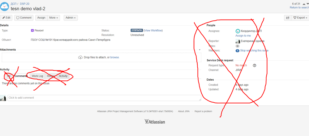

Hello,
I have a y peculiar request from bussiness. I need to simplify agent's interface as much as possible: can I somehow hide these fields (see the screenwhot attached) from agent's view?
I am afraid this is rather urgent for our bussiness. So looking forward very much to hearing your ideas!

Hello,
Javascript. But it s an ugly solution. Difficult to mantain.

You can use Jsincluder plugin to add your Javascript there.
If it is Cloud, then it is impossible

Jsincluder will let you store your JavaScript and link it to create, edit, view, transition screens. But all logic you have to develop yourself. There is JQuery available, that is why if you want to hide an element it would be like this
AJS.$("elementselector").hide()
You can hide not only elements buy whole divs.
The problem is that
1. If you want your solution to work for certain browsers, you would need to test your code on all required browsers.
2. You will not find oficial documentation how to make this kind of tuning, which means Altalssian does not support it. As a result there can be complication. I met a couple which were too difficult to overcome because I would need to fix the Atlassian javascript.
3. When you have too much Javascript, it becomes difficult to support the system. And usually Javascript code tends to grow fast.
You case is simple but usually if you begin to tweak Jira with Javascript then it is difficult to stop.
