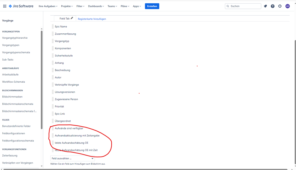

Almighty Drake
December 4, 2023
In the Screenshot the Custom Field is assigned to a issue type screen and i added it also to an issue, which is secondary since i just want to see the field on any issue type.
However I still cant see the custom field on an issue type screen when i create an epic or any other issue type.
Did i forget smth?

Walter Buggenhout
December 4, 2023
Hi @Almighty Drake ,
I am afraid there is no such thing as an issue type screen. There's just screens.
Your screenshot just shows a screen. At the top of that screen is the screen's name. Before doing anything else, navigate to the project where you are trying to create an issue and check the following:
  1. in the bottom left corner check if your project is company-managed;
  2. navigate to project settings > issues > screens and make sure that you see the same screen listed there as the one you shared a screenshot from.
  3. If so, make sure that this screen is associated with the create operation for the issue type you are trying to create. And - expanding on that - make sure that this is the case for all issue types you want to see the fields on.
  4. If all the above items seem correct, then check out project settings > issues > layout and make sure that the fields are not in a hidden section there.µ
Screens are associated to projects using schemes. So you don't just need to add fields to a screen, you should also ensure that screens are linked to the project(s) you want to use these screens or update any other screens also used in different projects.

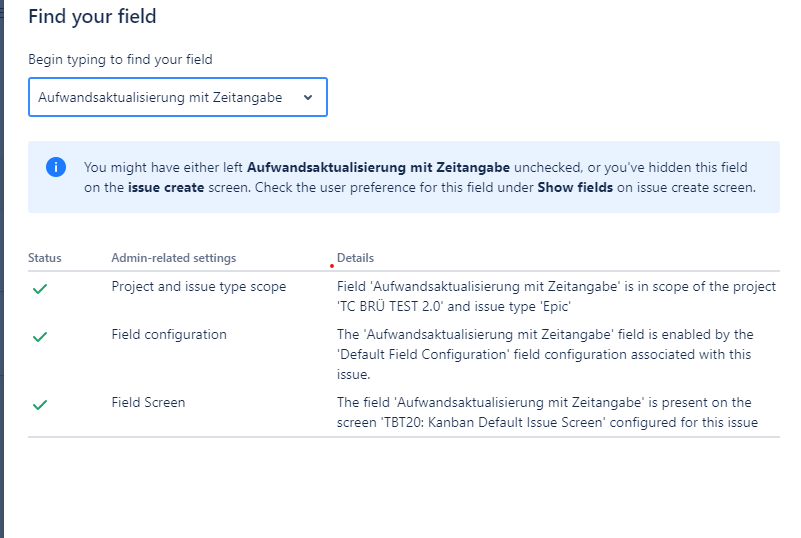

Almighty Drake
December 4, 2023
I followed the last step on find your field...
can you instruct me what to do next?

Walter Buggenhout
December 4, 2023
What to do next is in the blue rectangle on your screenshot. This is where you can find show fields on the issue create screen:
To delete fields on the screen, yet again: locate the screen from project settings > issues > screens. Open the screen design in the same way as you did when you first added the fields. And then click the remove button that appears when you hover over a field on your screen.

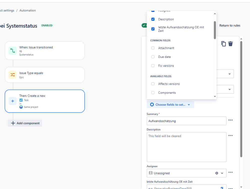

But how can I include my custom fields when it comes to automation... so when the automation creates a task or sub task... how can i configure the fields on autogenerated issues?Screenshot 2023-12-04 153415.png
is the "choose fields to set" field for customizing autogenerated issues?
or whats the field for ?
Walter Buggenhout
December 4, 2023
The choose fields to set option lets you select all the fields you are going to fill out in the newly created issue. They then appear one below the other, where you can decide what value they should get. You can choose to hardcode the values or copy them from elsewhere.
