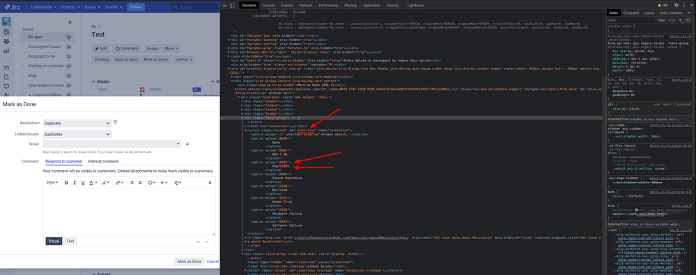

Below is a print screen from where you can get the details of the values you should use:-
When you inspect the element with your browser, you will notice the field id for the Resolution field in lower case, and also, you can see the form value that is used as highlighted in the print screen above.

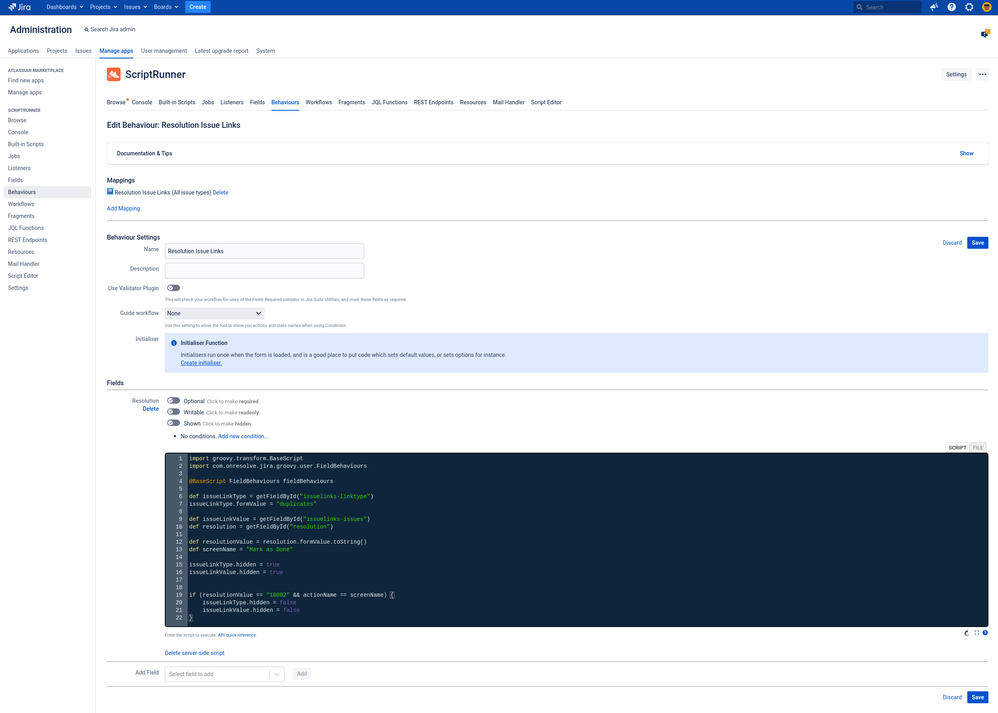

So in this example, when the dialog first appears, the Linked Issues option will be hidden.  Only when the Resolution list is updated to Duplicate will the Linked Issues option be visible.
Below is a print screen of the Behaviour configuration that I have tested with:-
