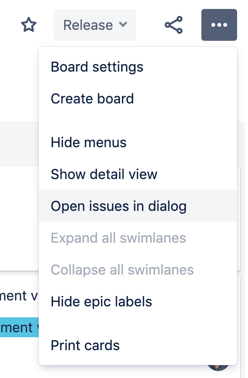

Had the same confusion, seems like at some point I switched this off, but you can turn it back on by going to the three dot menu on the kanban board:
