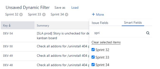

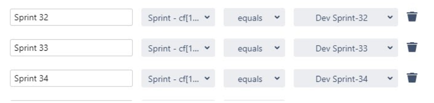

If you are still looking for a way to set up multiple backlogs and sprints for one project, you can try Dynamic Filters: JQL Replacer addon (created by my team). It allows you to set requests easily without JQL knowledge.
All you need is to choose the required data with the help of a visual designer:
Then save it as a dynamic filter:
Thus, you can use it whenever you need it.
