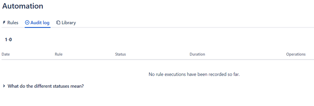

Leslie_Hernandez
July 13, 2022
My apologies @Bill Sheboy , It looks like we do not have any automation rules. I believe due dates were entered manually. automation1.PNG

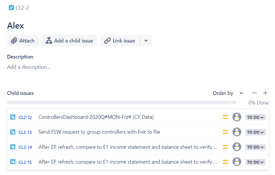

Would i still be able to create a rule so the parent task can pick up the earliest due date from the child tasks? child task.PNG
These are my current child tasks with due dates, but i want the parent to pick up the first task's due date since its due first.

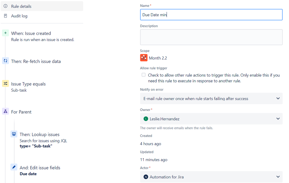

Leslie_Hernandez
July 13, 2022
I have not been able to figure out how to properly do the "Then: look up" step (second to last)
Thank you!
Bill Sheboy
July 13, 2022

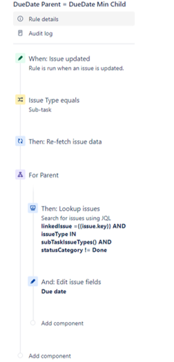

For your lookup issues JQL, you want to find the sibling subtasks of the same parent.  This can work for that from inside of the branch.
linkedIssue ={{issue.key}} AND issueType IN subTaskIssueTypes()
If you want to ignore the Done issues, add that part to the JQL:
linkedIssue ={{issue.key}} AND issueType IN subTaskIssueTypes() AND statusCategory != Done

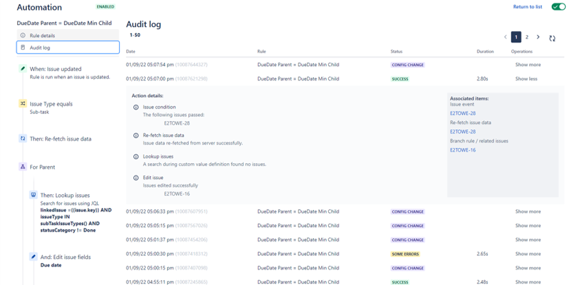

September 1, 2022
Dear @Bill Sheboy
I have a similiar problem, but it does not run as I imagined:
Why does it not find the siblings?
Thank you in advance.
Bill Sheboy
September 1, 2022
Hi @[deleted] -- Welcome to the Atlassian Community!
Are you using a company-managed or team-managed project?
And...are you trying to do this for linked issues or parent/child relationships?  If parent child, please try updating the lookup issues action's JQL to check for parent instead of linkedIssue.
