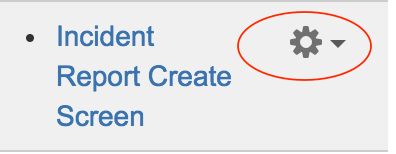

I am assuming that you created the screens with the fields in them?

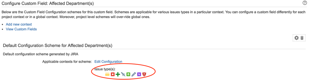

Go to Fields -> Custom Fields select one field and then click on the Cog on the right side of the field.
Select Configure then click on "Edit Configuration"
You want to make sure that the issue type is available:

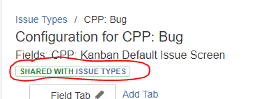

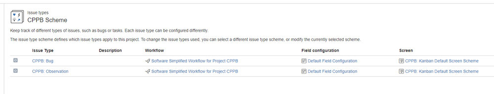

is it because these two issue types have the same screens? if so how do i change it? @Tinker Fadoua
@Jonathan Libovnot sure how I can help next, I can get another champion involved see if they have a better way than mine 😉
Yes @Jonathan Libov if two issues are using the same screen there is no way you will get the expected results you are looking for
You have to create a screen for each issue type
ok now we're getting somewhere! how do i edit the screen for an issue type though?
