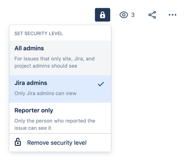

To properly edit the security level of an issue as a Jira administrator, you must do the following steps:
  1. Navigate to your project > Project settings > Permissions > Add your user with the Set Issue Security permission
  2. Navigate to the hidden issue and click on the lock at the top-right corner to change the issue security:
  3. If the steps above didn't work, navigate to the project > Project Settings > issue Security > Add your user to the issue security scheme and add your user to the security level applied to the issue. Then, execute step two again.
