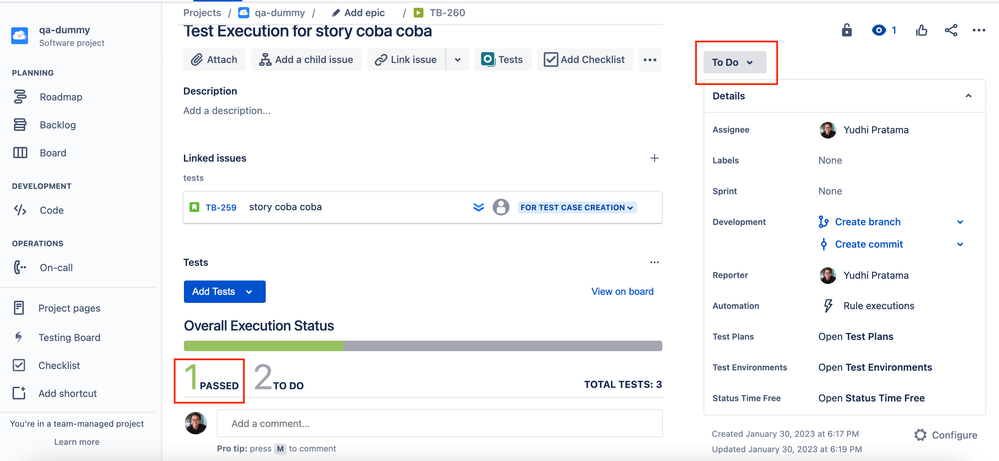

Hi, I'm new using Xray Jira for test case management, previously I'm using testrail.
I have a question regarding, can we set the test execution status automatically when one of the test case include in that test execution is already changed from to do to passed/failed?

in general the status of a jira issue can be changed via Automation for Jira based on several triggers. The good point: an xray test execution is handled as a jira standard issue. The problem: test runs (which is what you mean with test case --> test run is the instance of a test case that is run within a test execution; every time you add a test case issue to a test execution issue an instance of that test case is generated within that test execution which is then called test run) are not handled as jira issues and it might be hard (if possible at all) to grab this event within an automation rule.
There might be a possibility via the FraphQL API (see link below) to grab testRuns:
https://xray.cloud.getxray.app/doc/graphql/gettestruns.doc.html
It just might be pretty difficult to get the automation rule triggered as there is no possibility (or at least I dunno any) to set a webhook for that.
Hope I could at least give some helpful input.

@Yudhi Pratama  did you solve it via GraphQL? If yes, could you please share the solution?

The problem is with trigger as there is no such direct trigger I found. I am able to change the  Status of Execution based on Test Runs'  status using GraphQL through Field Change or Comment  trigger ( used just for testing) but it'll not save time and is equivalent to changing the status manually. I'll explore webhook.
