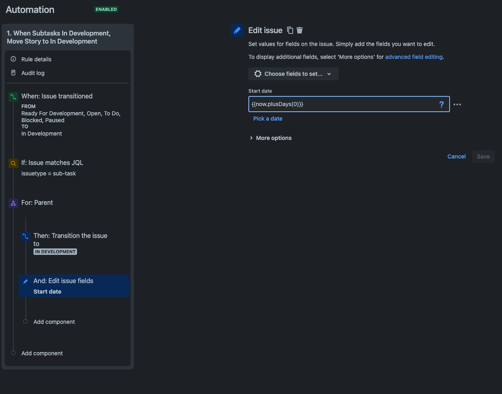

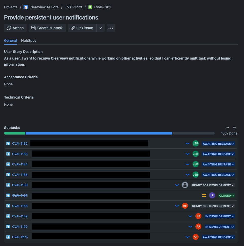

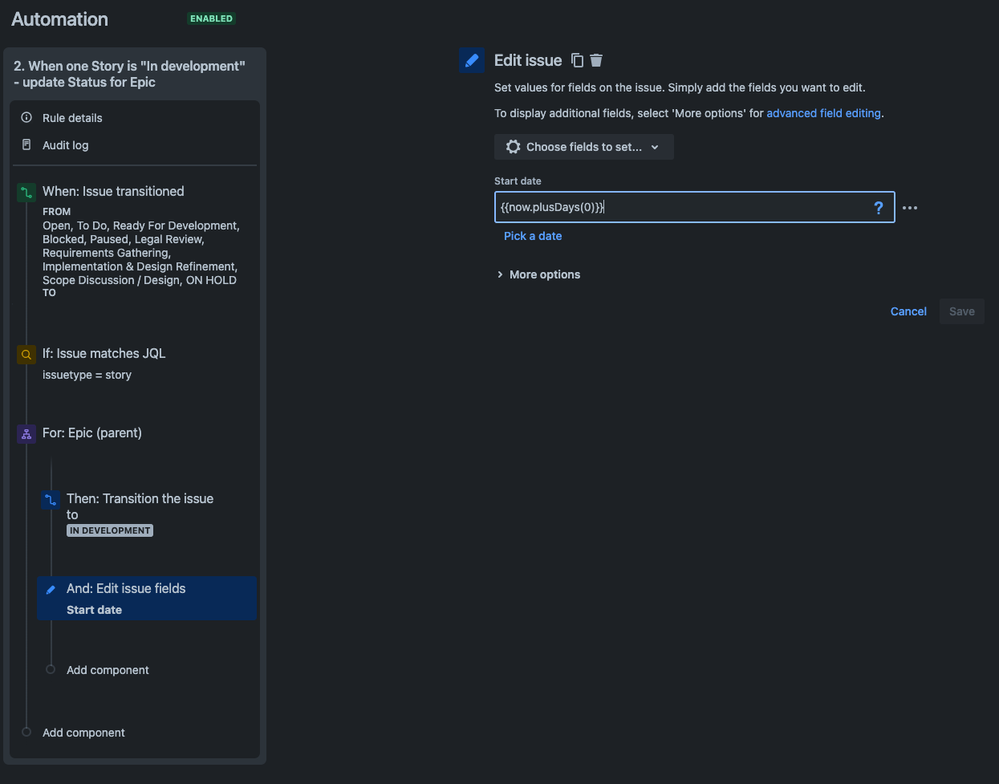

I would like to set the Start Date on a Parent Issue (Story and Epic) when the FIRST story or subtask gets moved into Development.
I have an issue where every time a subtask or Story moves into Development the Start Date Changes on the Epic or Story Level.
There are times where the subtask are in different stages of the workflow, but the start date keep changing every time that it may go in and out of a status. See Example screenshots.
Example Story with Subtasks.pngAutomation Rule Start Date - Story.pngAutomation Rule Start Date - Subtasks.png

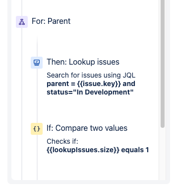

You will need to add Condition(s) to check if there is more than one "child" issue in the "In Development" status and only change the Start Date of the parent when there is only one "child" issue in that Status.
Something like this should work:

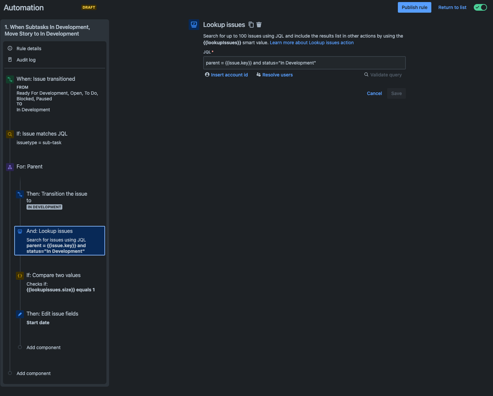

@Trudy Claspill @hank you for the quick response. Should I add this to my Existing Rule when I not only transition subtasks to "In Development" and update the User Story status, also the start date?
Also, for some reason the JQL Lookup issues is not able to validate the query. Is that look correct?
parent = {{issue.key}} and status="In Development"

In an Automation Rule the Validate Query option will not work when the query includes smart values, because the smart values cannot be evaluated except when the rule is executing.
As per your latest image the parent's Start date will updated only when a subtasks transitions to In Development and that is the only subtask in that status. The change of the parent's Status will not be affected by the change.
