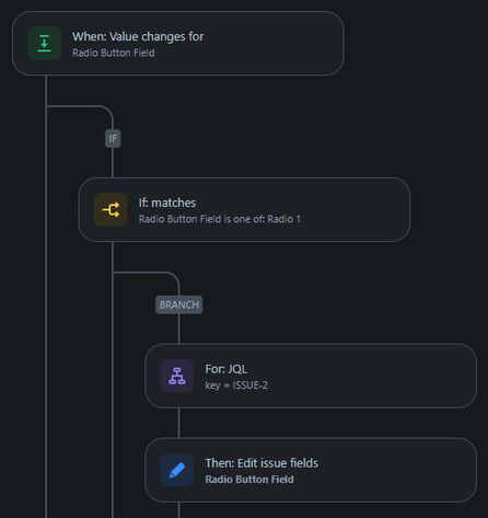

where I've just used branch to find that other 'fixed' issue for which radio button field should be changed. By just adding IF/ELSE (e.g. if Signature = Active > set Signature in other issue to "Passive" and vice versa), this should work.
Now, it all also depends if you're going to configure this on project level, or do you need to configure it on a global level, without the need to specific issue keys for other/linked Signature issue.

It will be easier if linked. Otherwise you can run a JQL branch. Make sure to uncheck "Check to allow other rule actions to trigger this rule. Only enable this if you need this rule to execute in response to another rule." as update of the field edit the same field.
