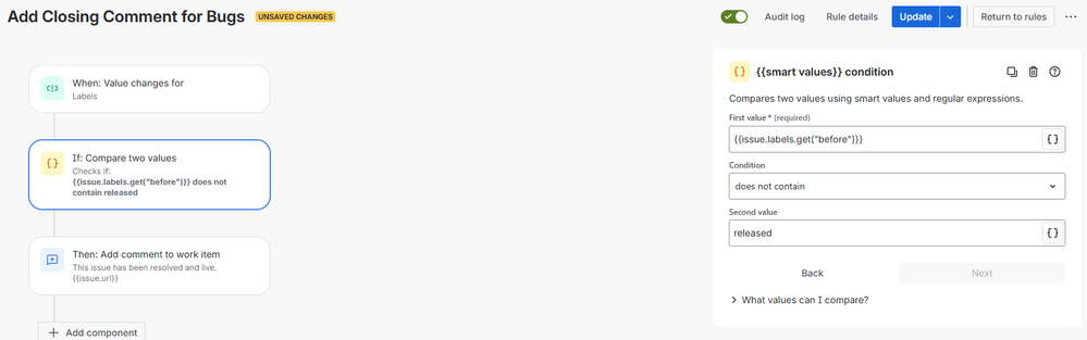

I am trying to setup my automation so that when a specific label (released) is added, it will trigger the automation to add a comment. However, I do not want it to trigger again if additional labels are added afterwards. I have tried using the smart values condition option, but it still triggers when I add other labels after. I am guessing the value I am trying to use is not correct. "{{issue.labels.get("before")}}" does not contain "released". Is there any way to accomplish this? Thanks in advanced

Try this smart values.
After the trigger, put 2 compare conditions.
1.{{fieldChange.toString}} contains  released
2. {{fieldChange.fromString}} doesn't contain released
Together these ensure the rule only fires when released is newly added — not when it’s already there and you add or remove other labels later.
Let me know, if this works.

Please try using the field change smart value for only the added values:
https://support.atlassian.com/cloud-automation/docs/jira-smart-values-issues/#--fieldChange--
Note this may be an incomplete solution as there is nothing stopping a person from adding the label, removing it, and adding it again.  When you want one-and-only-one comment for the first time the label is added, you could add a conditional check to detect if that comment has ever been added before by checking the prior comments.
