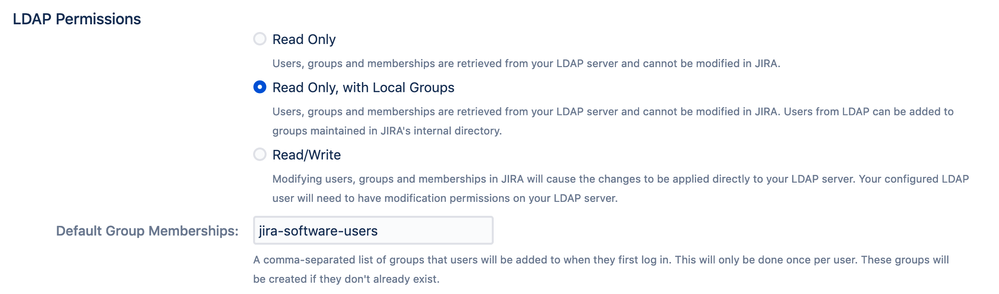

Set user directories in Jira Software Data Center, this path:
User management > User Directories > Directory Type: LDAP >
Configure LDAP User Directory > Directory Type: OpenLDAP > LDAP Permissions > Default Group Memberships: jira-software-users
After sync the users from LDAP server, they aren't been set into 'jira-software-users' group, so they can't be used.
Why and how to config it correctly?
Hello @Raw Main did the user try to login? As the text of the image shows, the group isn't assigned until the user logs in and this might be the case here.

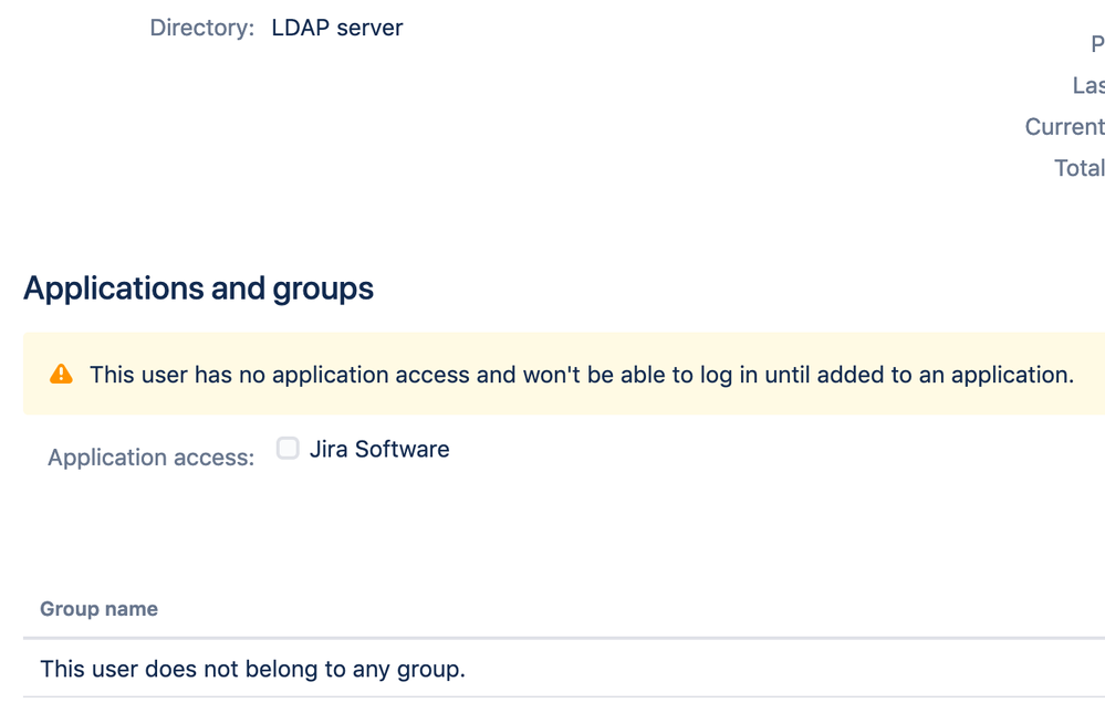

I tried again. The user is in the 'LDAP server' directory now.
But tried to login again, got:
> You do not have a permission to log in. If you think this is incorrect, please contact your Jira administrators.
Hello @Raw Main removing a user isn't simple, pretty much nothing must be associated to it. You could deactivate it instead.
Could you please tell the user directory order? That defines where Jira is going to look for the user first
Hi @Hernan Halabi - Elite IT Consulting Group I have remove other directories and keep LDAP server only, so the user can login!
The reason was there ware multiple directories before. Thank you for your help!
