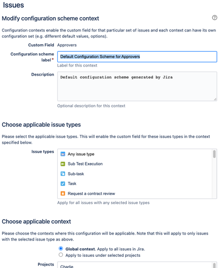

Yes, if you go to Settings > Issues > Custom fields and click on the three-dot menu on the right of the field you will see Contexts and default value. From here you can change the configuration so that the field is only associated to a specific issue type and/or a specific project.

Regarding the second point - if I understand correctly this DOES change the (shared) field configuration scheme but this change is only visible for the selected projects (aka applicable context)

Changing the configuration of the custom field will not change the shared field configuration scheme. You would still see the custom field in the scheme, but the field would only be visible to the issue types/projects that you have defined in the context. The only time you would have to create a separate field configuration scheme would be if the custom field should be required in one project but not in any other.
