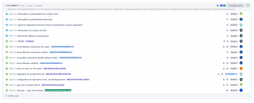

In my sprint board, we have the active sprint with our stories and story points defined. I would like to create an automation rule that send a notification to our Microsoft Teams when the story points is over a certain limit. 40 points for example.
In the image below, you can see that the total story point estimate is 38, how to I get this value and use it as a condition in Jira Automation. Thank you.

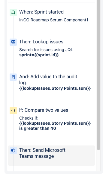

It is fairly simple to create a rule that checks the total story points for a sprint when that sprint is started.
