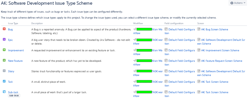

This screenshot is of a "field configuration scheme".  You've chopped off the "add" at the top right of it and the "change" options in the rightmost column, but those are what you need to use to add new field configurations or change the existing associations.

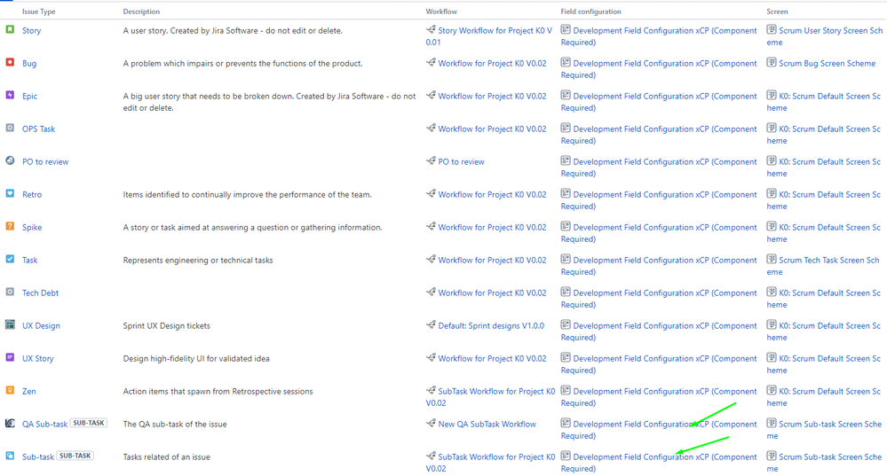

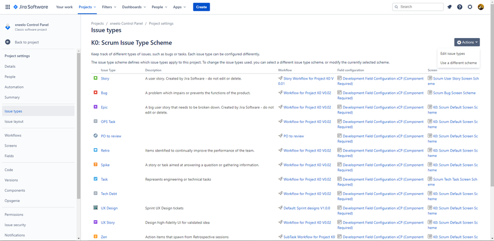

Sorry - this is the Issue Types page - I don't seem to have the options you mentioned.
If I "Use a different scheme" then it prompts to change the entire project.
Would this perhaps have something to do with permissions? I am an admin but maybe there's some things I'm still not allowed to do.

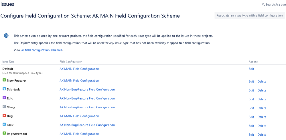

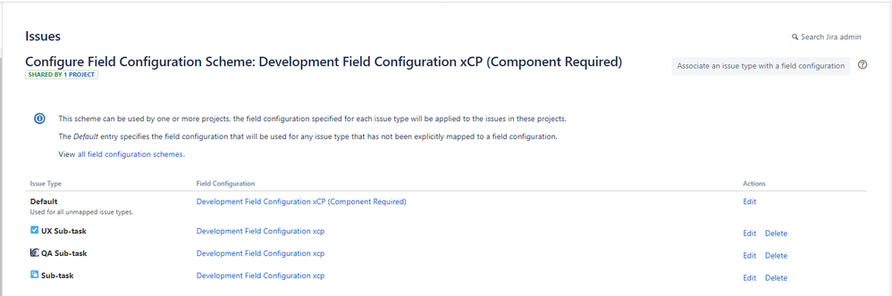

So essentially, the fix for me is to go to my currently selected Field Configuration Scheme and "Associate an issue type with a field configuration" - adding each subtask and linking them to the Field Configuration that doesn't have a required field.
Thanks again for your speedy responses and for pointing me in the right direction :)
[Edit] Here's a screenshot for anyone else that might be as confused as I was ->

When I go to check which Issue is associated with a Field Config, I have this:
How do I get the desired Field Configs to be used instead of Default.   I have a feeling I am one window away from how to configure this . . . .
