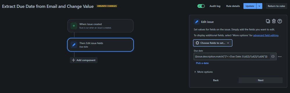

Matt Miller
February 6, 2025
Thank you for the reply Bill! Would you try these in the same contexts? Here's how I had that regex set up previously, with "Due Date" as the selected field obviously.:

Bill Sheboy
February 6, 2025
In my experience, the only way to know if something works with automation's implementation of regular expressions is experimentation and testing.  So try it, and if it works, great!
There are several community posts observing expressions which work in other regex parsers and do not work in rules, such as some of the on/off flags.  Some other possible challenges with rule use of regex are:
  • As per the documentation, only one match group is provided
    • Workaround: match on an entire larger expression, then use text functions or additional matches to parse out the pieces
  • Racetrack errors, where the match() or replaceAll() may not process fast enough for the usage.  This definitely happens in the Send Web Request action, the Edit Issue using dynamic JSON, and sometimes with Asset value parsing.
    • Workaround: when possible, use a created variable to fully evaluate the expression first, and then use the variable where the match() would have been used
  • Escaping characters in the search expression may not process as expected
    • Workaround: using three created variables, first create the regular expression, then use two other variables to perform escape addition / replacement, and finally use the result as the match() parameter
  • Cannot use issue fields / smart values in regular expressions directly
    • Workaround: create the regular expression with the other fields in a created variable, and then use that variable as the parameter in the match()
