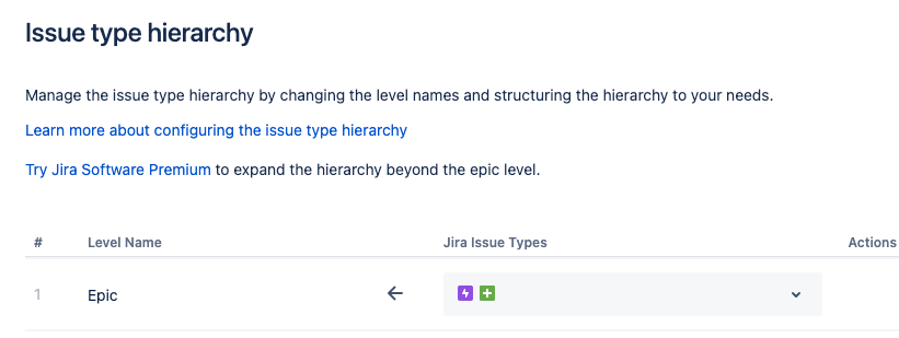

I tried adding a new issue type into the Issue Type Hierarchy at the same level as Epic.
Changing an existing Epic to that new issue type did result in the issue disappearing from the Epic level in timeline, like you saw.

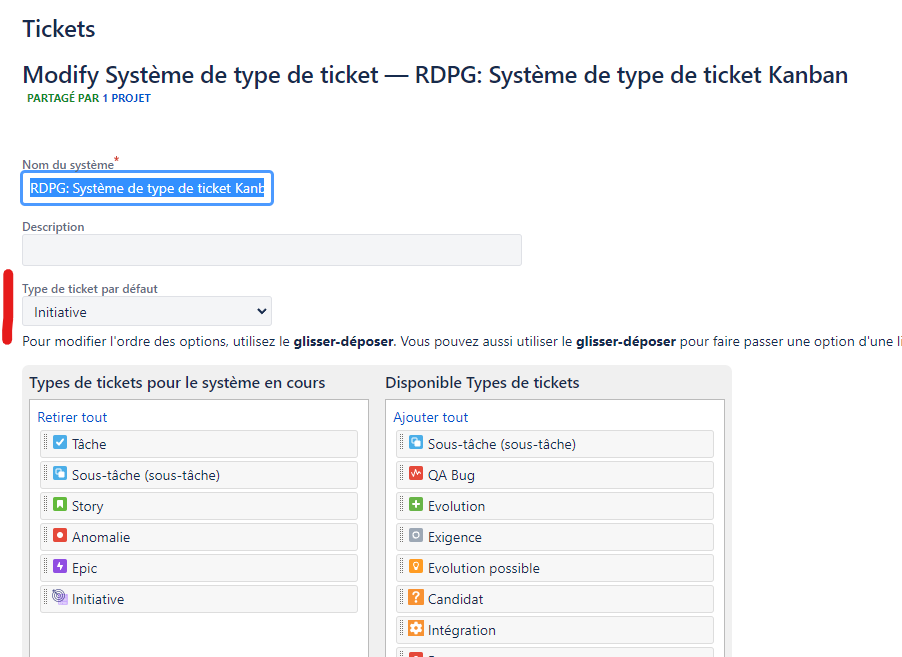

I thought that the phrase about the parent issue type referred to the "default issue type" of the issue type system:

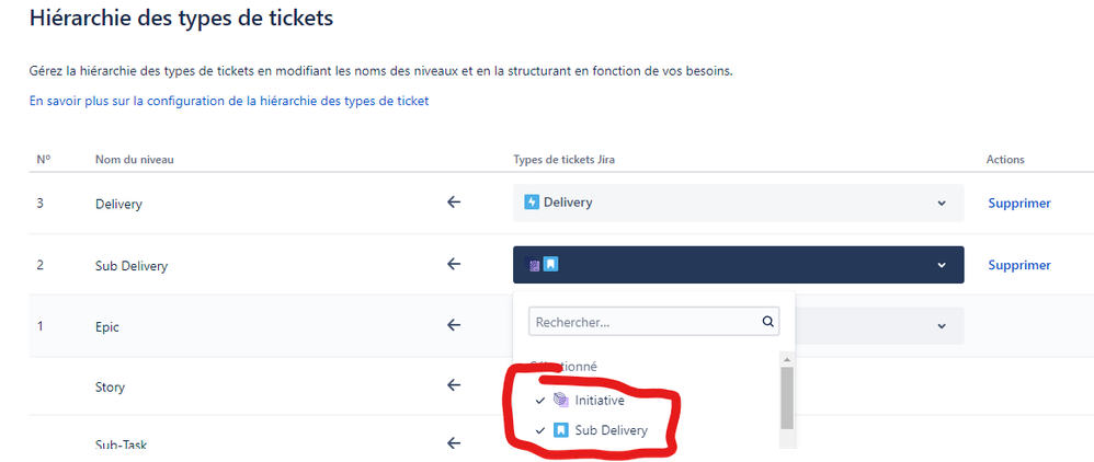

Then I thought that by making my new issue type above in  the hierarchy, it would work:
What you say is that even at the same level, it doesn't work. We agree on the fact that this phrase in the documentation is misleading somehow.

The ability to add issue types above Epic in the Issue Type Hierarchy screen is applicable only to the Advanced Roadmaps functionality. Those additional levels will display only in AR Plans.
The Timeline view is a more basic feature intended to work only with the default hierarchy levels.
