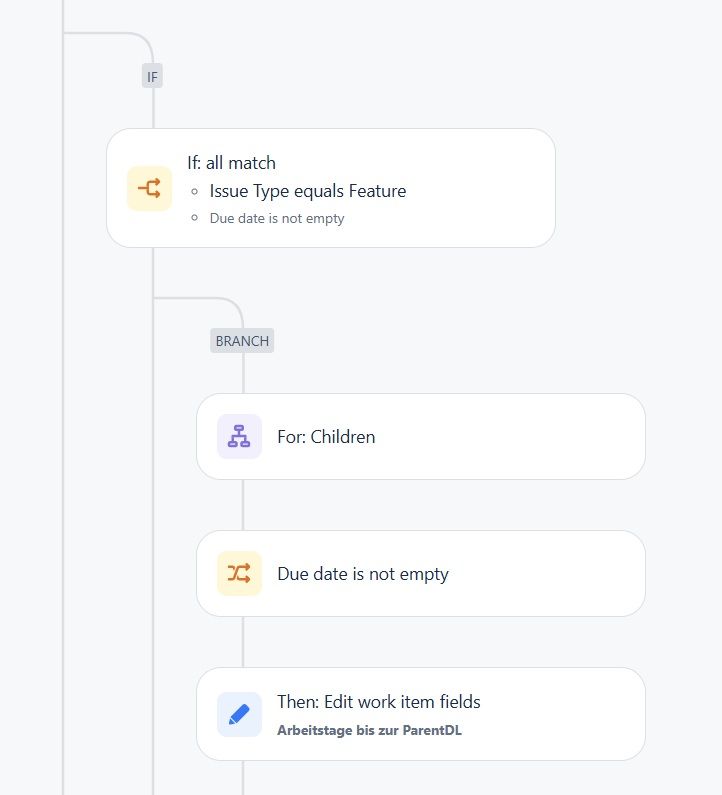

and after this we are checking on the issue type and on if the issue is currently not empty
and then triggering the executions.
The problem that we currently have is that we can not tell if the value was empty before or not and so we can only have one outcome, but we would need the 2 of them for this automation to work.

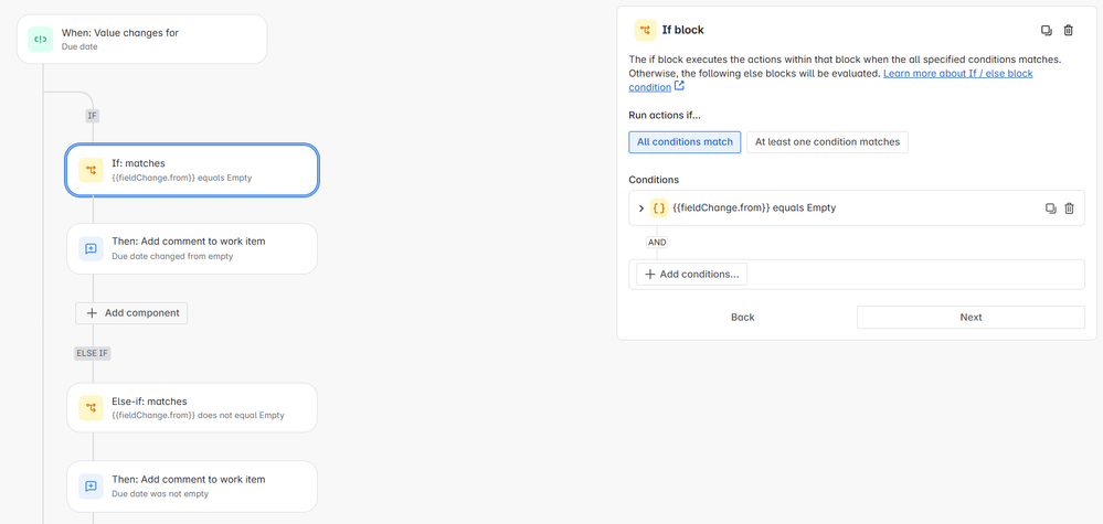

Bert Dombrecht
April 29, 2025
Hi @Khira Niemeier
You can use the {{smart values}} condition with the smart value {{fieldChange.from}}.

Khira Niemeier
April 29, 2025
I think I found the solution myself:
Using the {{changelog}} smart value fixes the problem.
Using the {{smart values}} condition works well.
the smart value {{fromString}}{{/}} asks for the previous value and this is exactly what we were looking for.
We have a second if request that asks for equals EMPTY and I just tested it. It works! :)
Mikael Sandberg
April 29, 2025
Since you are triggering on an action that edits a work item you can use the {{changelog}} smart value to see what the previous value was.
