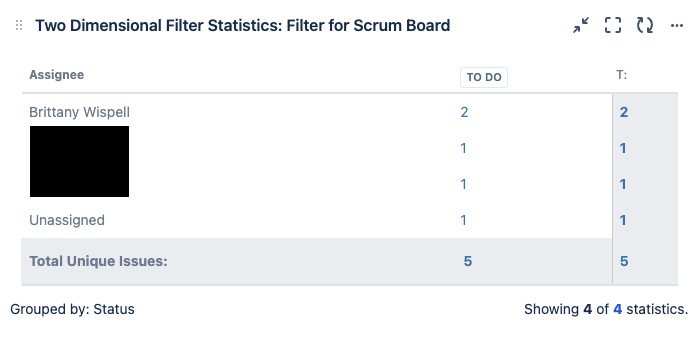

Alternatively, I would recommend using a dashboard to view this sort of information. I like to use the 'Two Dimensional Filter Statistics' macro to see this data. You can create a filter for just the 'Done' tickets in your project to display here.

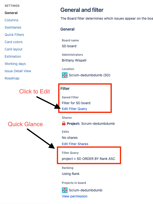

Hey @Carolina Noguera
Thanks for clarifying.
Let's check the JQL of the board first to see if the JQL is not including the Done status or status category. First if you navigate to the 3 dots ... at the top right of your board, then click Board Settings, under Filter Query (see image 1) check to make sure the JQL is not limiting the tickets in the board. (It should look similar to my set up)

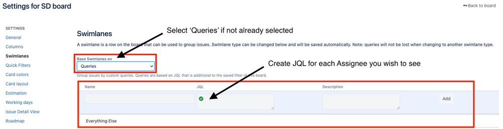

For the swimlane, you'll stay within the Board Settings and navigate to Swimlanes within swimlanes, you'll then set up the JQL queries based on the assignees within the project. (see image 2)

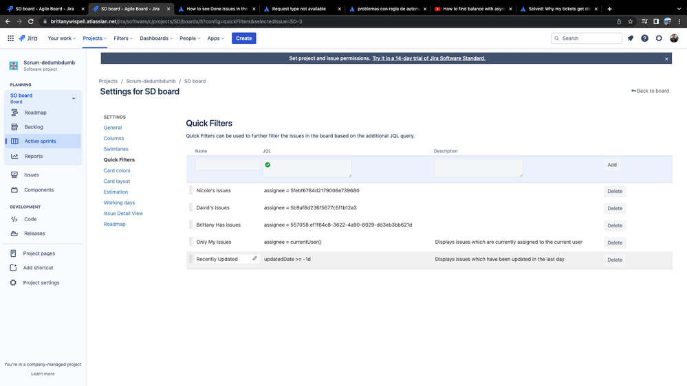

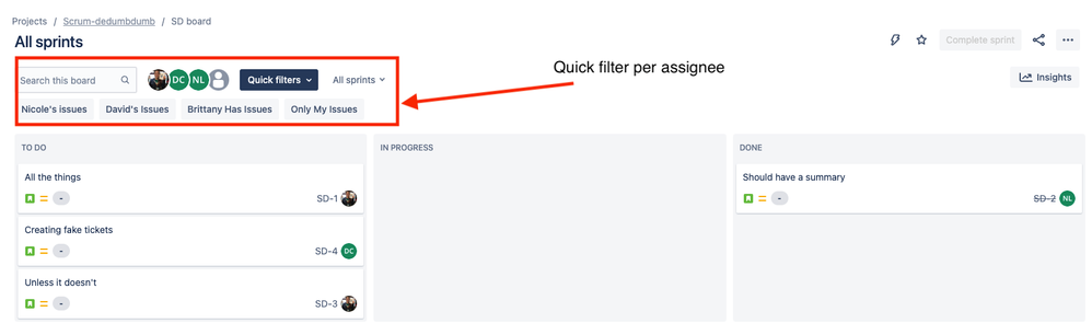

Another way to do this would be quick filters. (see image 3&4)

Image 2:
Image 3: (the set up)
Image 4: (the result)

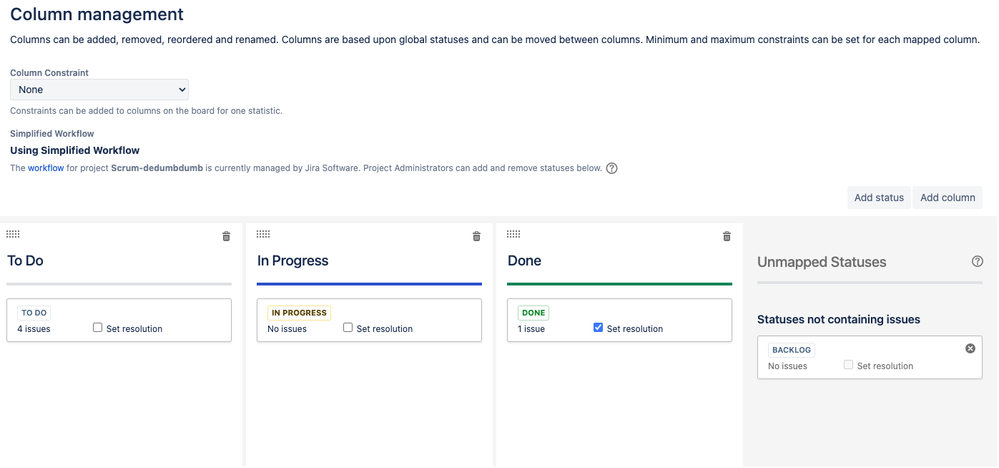

One last thing,
Make sure that the 'Done' status is correctly mapped to the 'Done' column. (image below)

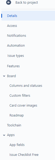

Carolina Noguera
August 10, 2022
This is what we have under board settings
