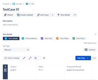

create Tetst (step-by-step-description of what needs to be done when running the test)
Now you have a documentation of your test steps. No more, no less. This doesn´t say anything about an execution.

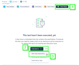

To now execute/run these test steps:
Create TestExecution (several ways, I´ll show just one of them)
  • Within your recently created test case change to tab "Test Runs"
  • click "Execute in"
  • choose "New test execution"

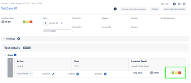

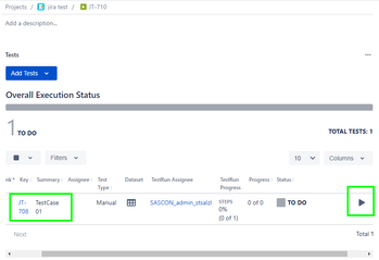

A test execution issue is created. As you can see it contains of a testRun an instance of our recently created test case (see screenshot). This TestRun can now be "run/executed/started with the play button and clicked throug/set to fail/pass"
If you click the play button you will be directed into the TestRun where you can set status of test steps
This is mainly how running tests in XRAY.
