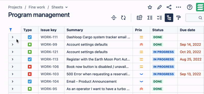

This being said, if you are open to solutions from the Atlassian Marketplace, there are tools that can help with this; just for reference, this is how this would look in the app that my team and I are working on, JXL for Jira:
(Note how in the above hierarchy, stories/bugs/tasks are shown as children of other stories/bugs/tasks - which wouldn't be possible in Jira's "regular" hierarchy.)
